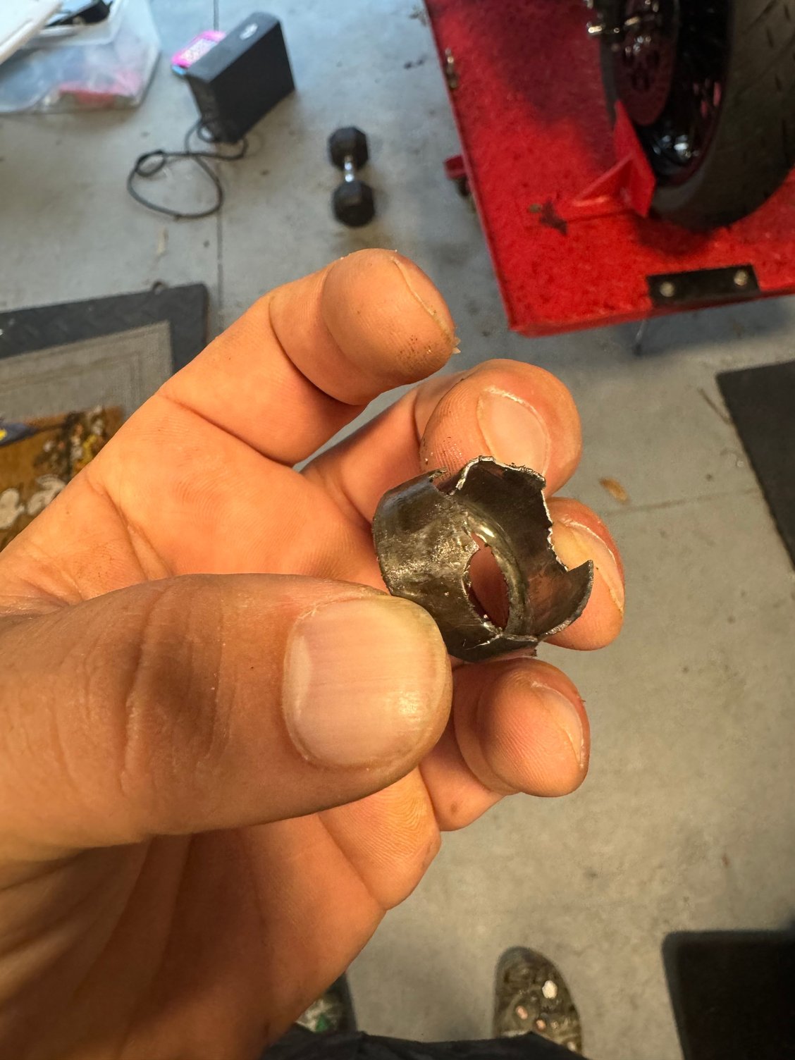

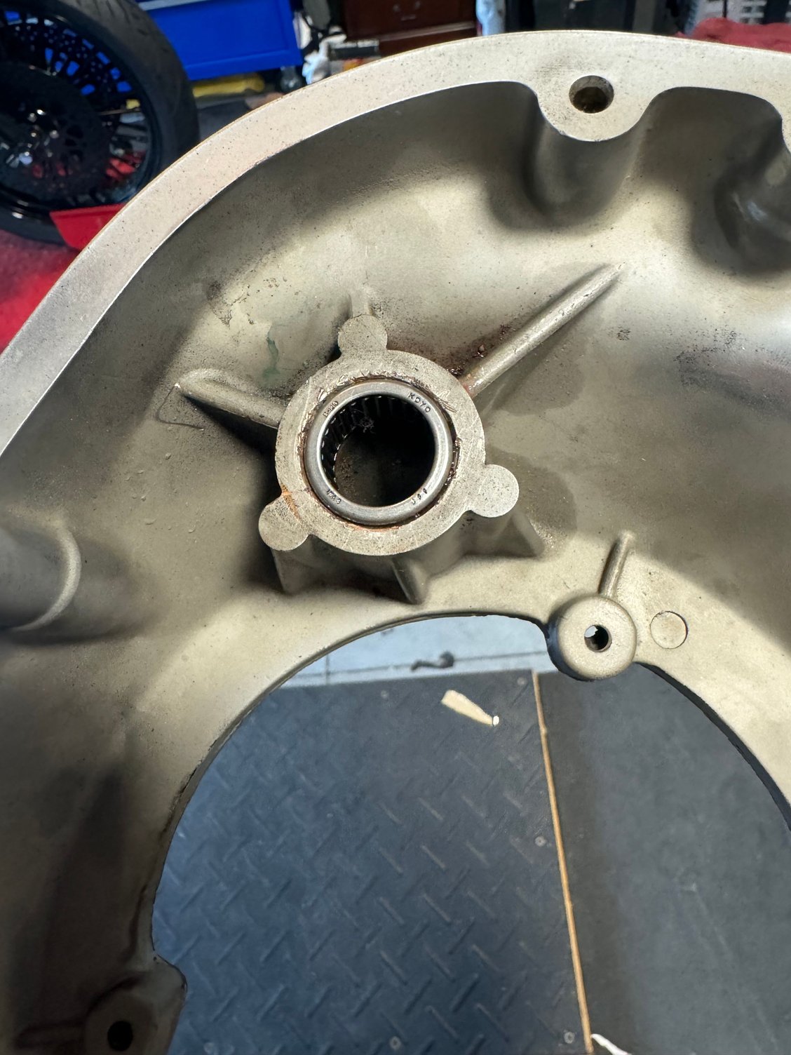

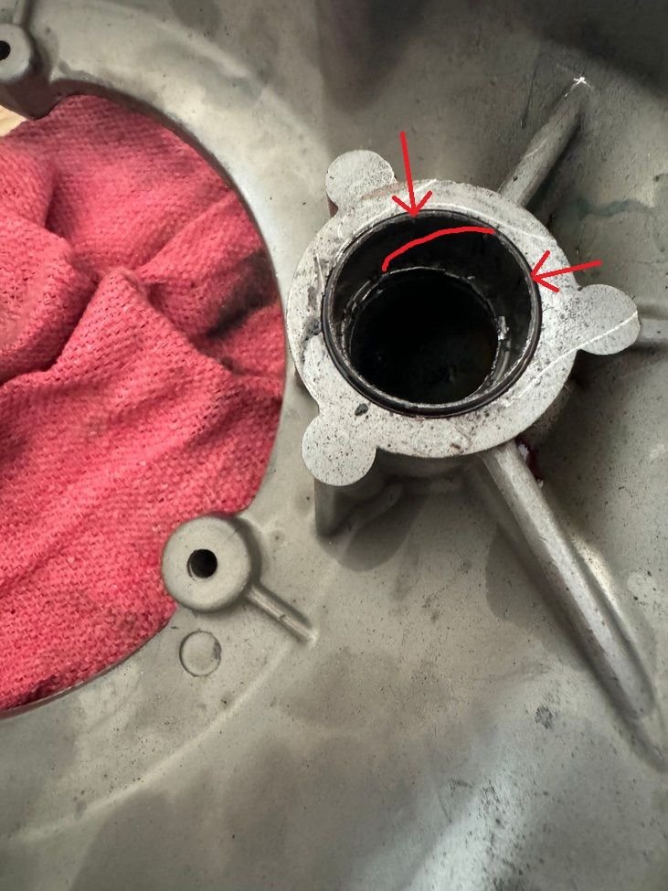

You can try a Dremel cut off wheel, cut on a angle so you don't cut into the housing, cut the slot almost all the way through, then get a small chisel and knock inward, the race is hardened so it should crack, if it doesn't crack easily, cut deeper, try not to, but even if you cut into the housing a little, it shouldn't affect the bearing press fit.
Old Oct 15, 2024 | 07:50 AM
  #122
JG321's Avatar
JG321
Joined: Apr 2024
Posts: 68
Likes: 105
From: Daytona Beach
I hadn't even seen this response, but that's exactly what I did. Carefully used that cutoff wheel and then used pliers to bend the outer sleeve along those cuts, between the bending and the cutting, it started to just fall apart and was able to pull it out with some pliers. Glad someone else had the same idea and I wasn't just being manic by cutting lol.

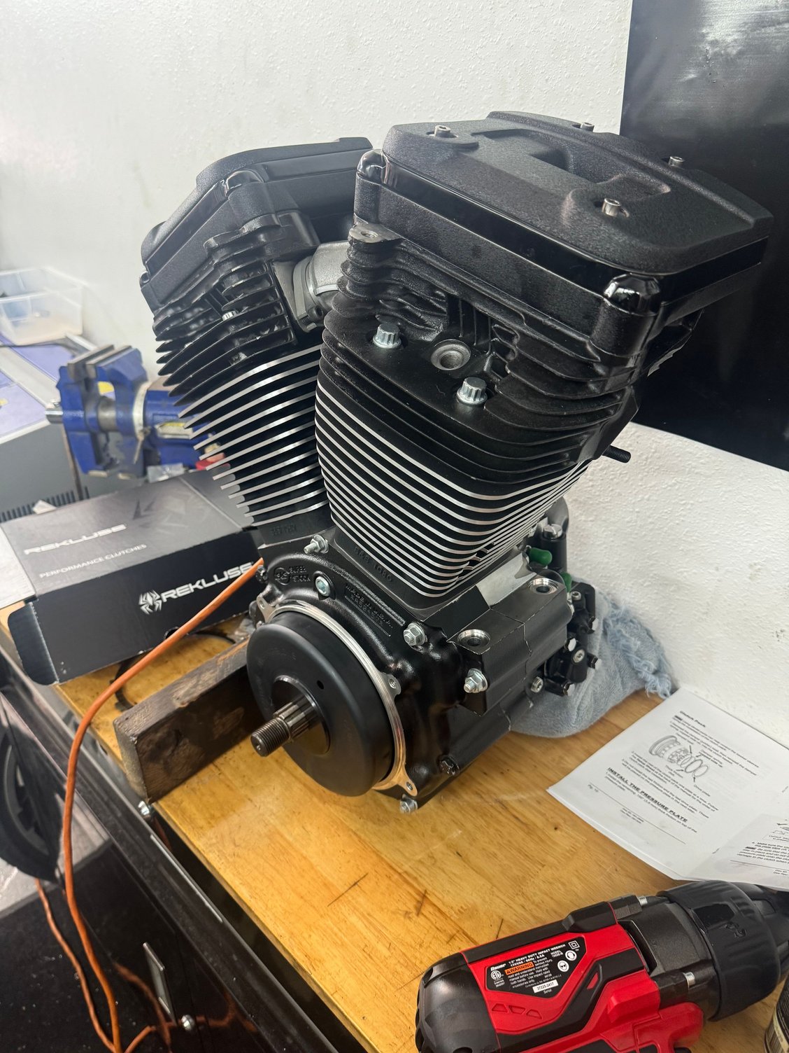

Been a while since I've updated this. Not much to report, life has severely gotten in the way these last two months. Two hurricanes, the holidays, a passing in the family, and work will do that though. The engine is completed however!

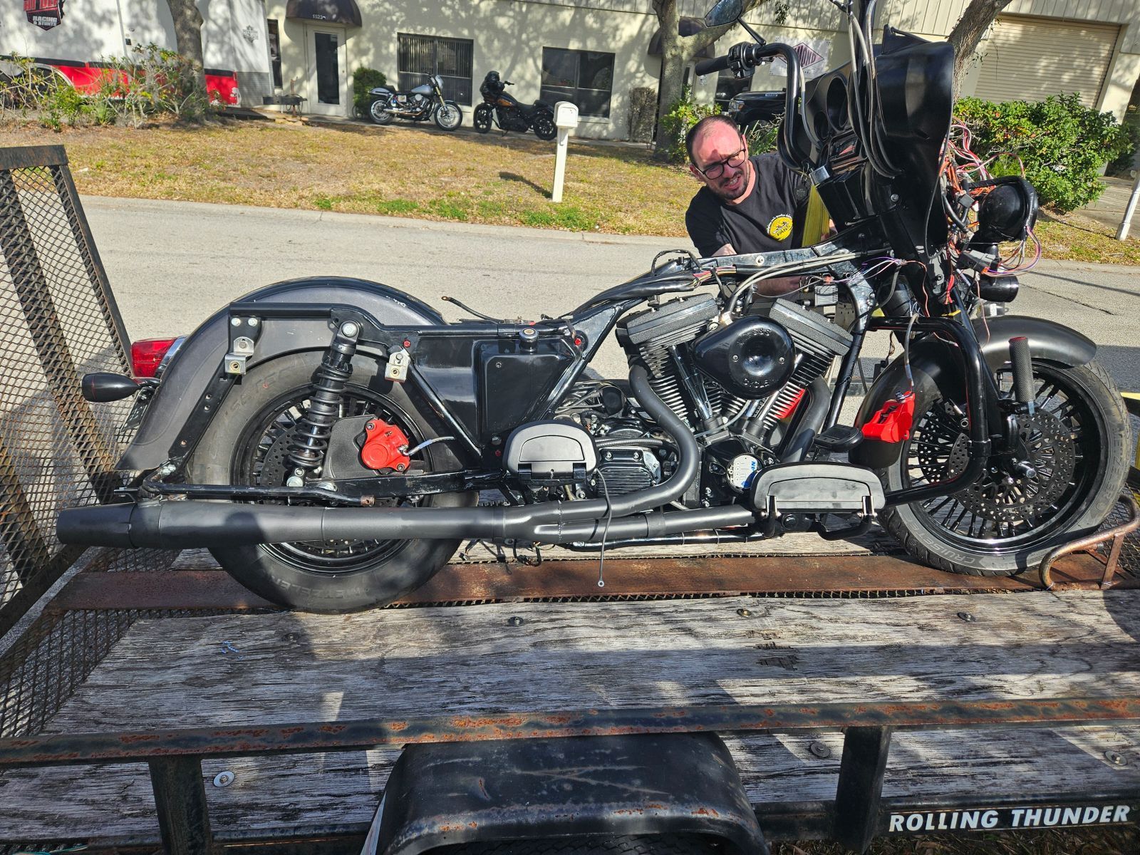

So close yet so far. It's loaded up to take it to a shop to get the wiring finished. Bike isn't firing, so hoping they can get that running for me.
