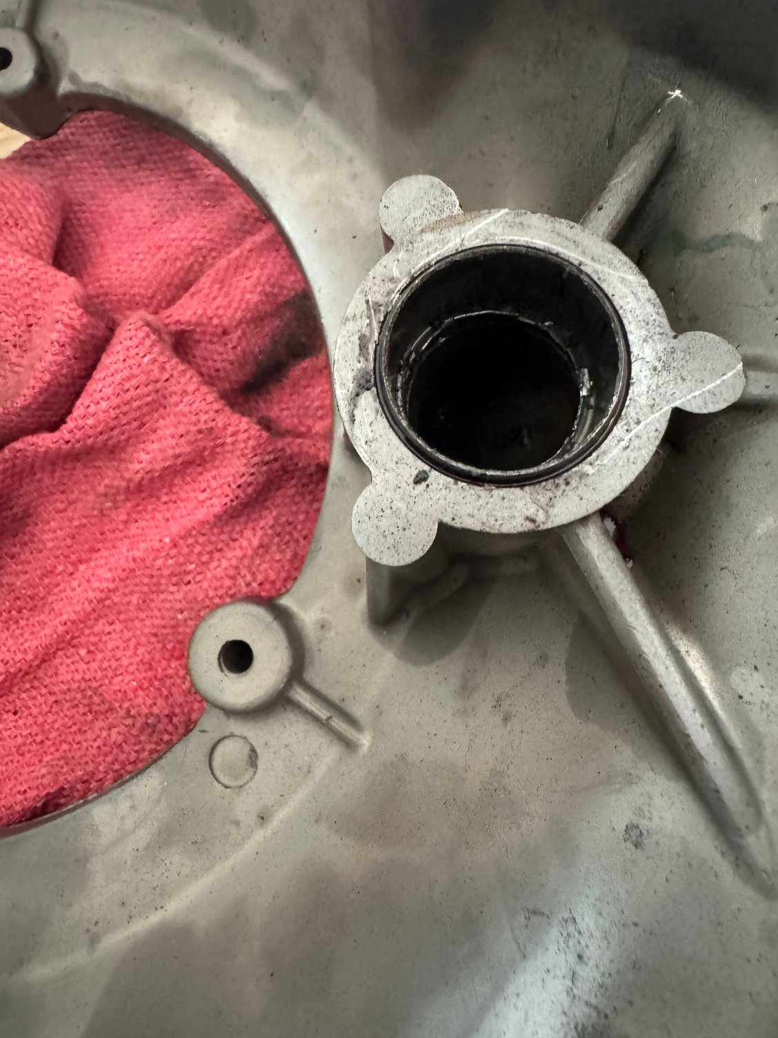

Posted in the mechanical forum too, but figured I might get a better response here.
I was trying to pull the outer primary bearing, using the correct tool, but then the bearing broke. The inner sleeve and the rollers came out, but the outer sleeve is stuck in the primary. Any advice on how to get that out?

I would first try heating the aluminum to expand. Then you should be able to take out the outer sleeve.

I had done that one from the start. the problem is now that the inner sleeve is ripped out, I can't get the tool to latch onto the backside of the bearing to pull it out. the bearing had come out ever so slightly, so I'm thinking I'm going to try and take some snips to the edge that is sticking out and carefully cut and peel the outer layer back.

Do you come with a mandrel from the back. If you do, you can hit the inner sleeve from there, small hits all around. Or if you have a Dremel tool, which you can try to cut a groove, then the bearing should come loose.
