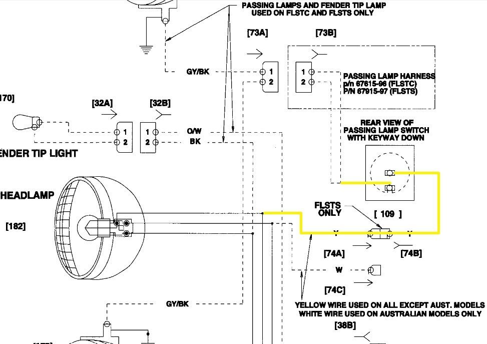

Assuming the wiring for the passing lamps is stock:
The passing lamp switch on the back of the fork tin gets its power from the low beam circuit (yellow wire coming from headlamp switch).
Pull the fork tin off, check the wiring at the switch.
Find the yellow wire that goes to the headlight. We know this wire is good, because the headlight works.
Look for another yellow wire that branches off this wire, that is the wire that powers the passing lamps.
I think the issue is somewhere in the wires highlighted.
