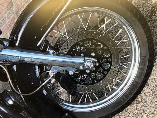

Originally Posted by 08xl1200r
I installed a Willwood caliper on my '98 Dyna recently and I'm happy with it. FWIW you will need to get new bolts, not included and the stock ones are the wrong length.
@08xl1200r Does the caliper float like OEM or is it fixed and was it a pain in as to get the rotor centered?? Can you post more pics looking down onto the caliper? Also do you have the dimensions of the bolts.? Thanks..

The bolts I got with the kit were fine, It is kind of tedious centering the caliper. The only thing I hate is the location of the bleeder.

No "centering" required
Yes, you need to bleed them off the mounts to access the bleeders
It is fixed but centering was on the disc was not a problem. As was said the bleeder is in a bad spot and that made bleeding the caliper a PITA. Sorry, I don't recall the bolt dimensions but I easily found the right ones at my local hardware store. They were ever so slightly too long so thick washers were required too...
