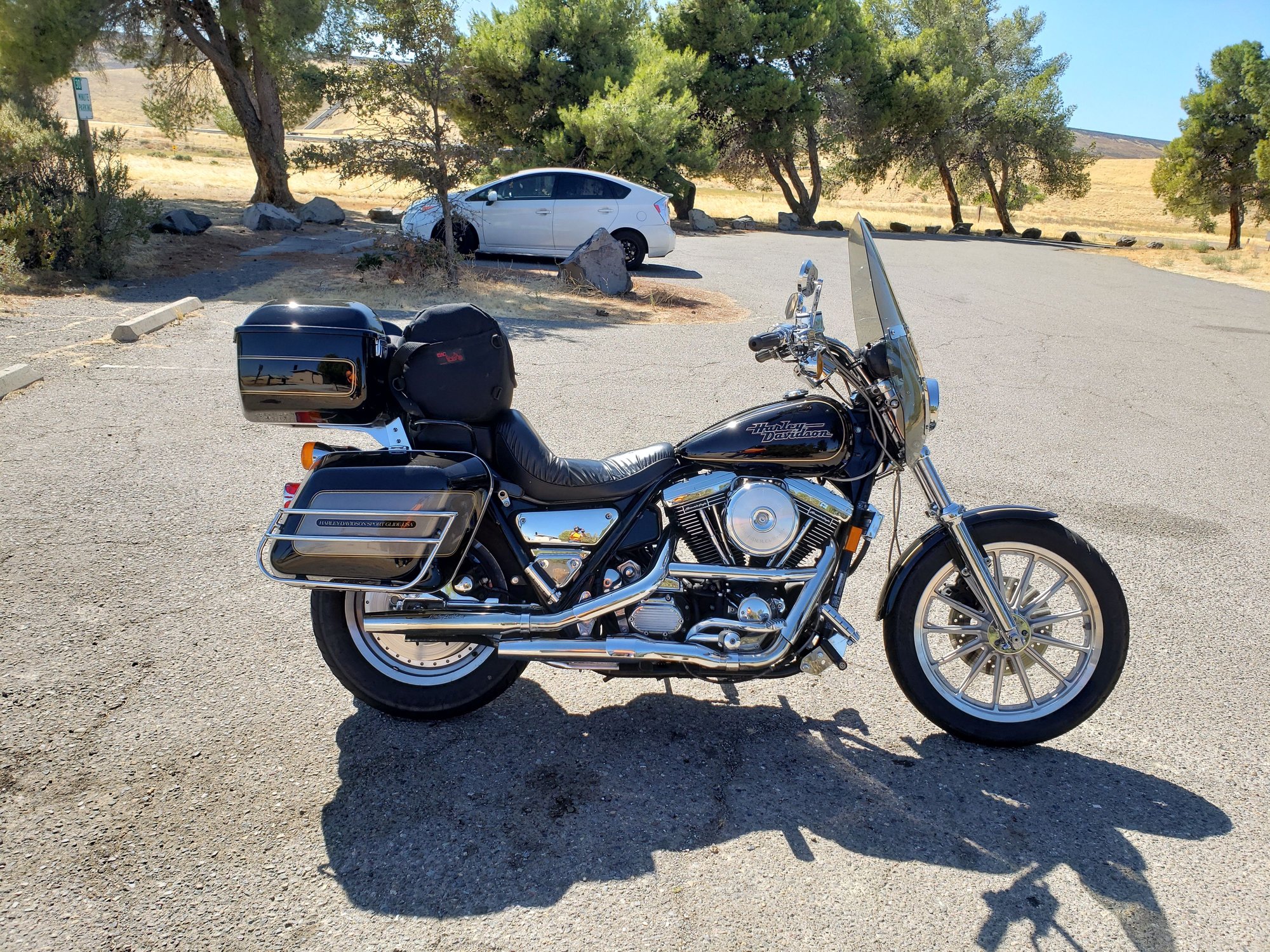

This FXLR has SE heads. .030 head gaskets, and a Wood W6 cam and Cycle Shack mufflers. I've never had it on a dyno but it runs real good.
Looks good. Thanks for the info!
