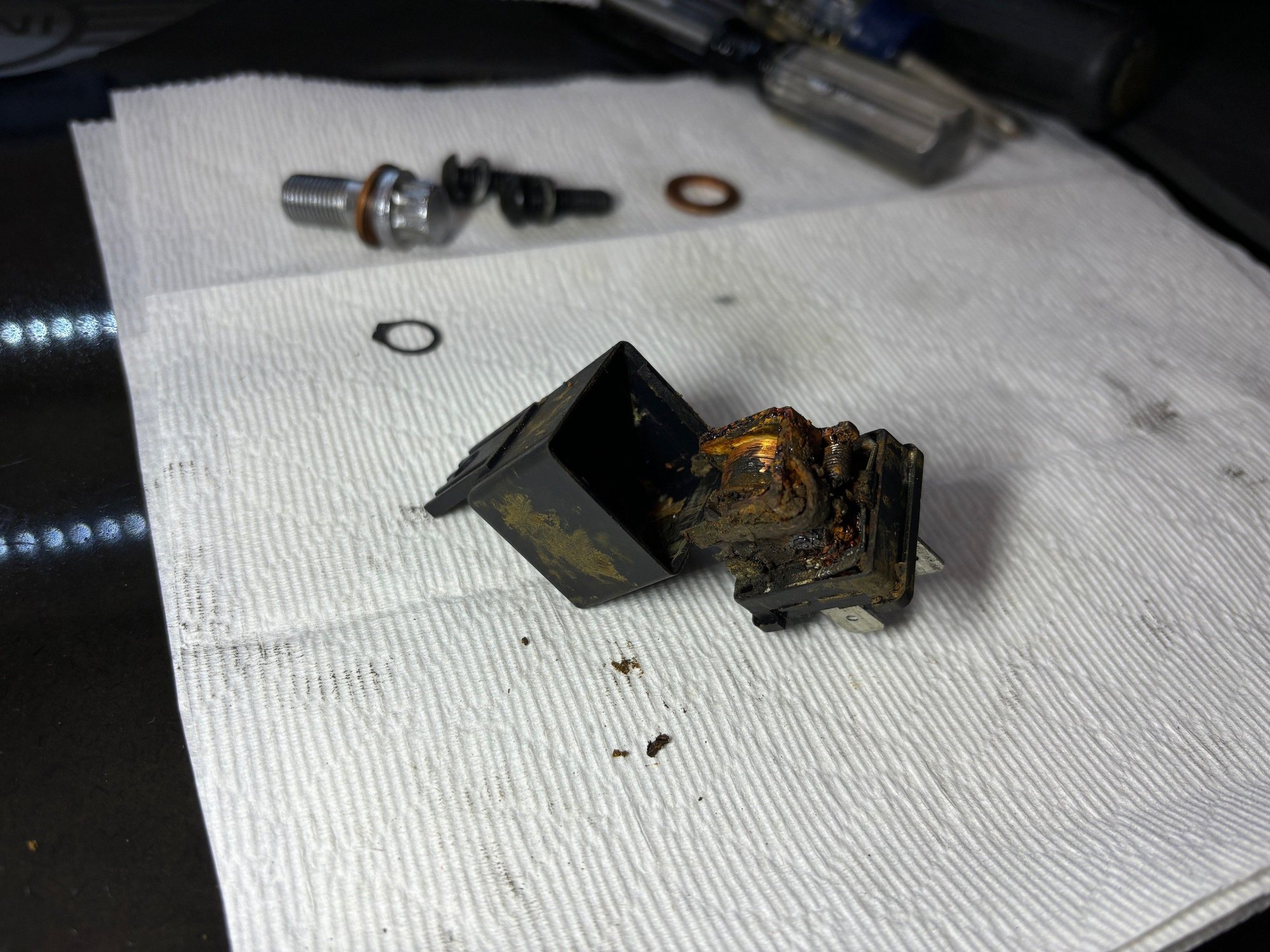

Update if anyone's wondering...
Starter clutch is a bit sketchy and will be replaced over the winter. That's what was binding up. I was able to jump the solenoid and get it to turn over and fire up so the solenoid is alive. Found the starter relay hanging under the oil tank, in front of the lower fender. Went to pull the relay out and it came apart. Looks like it got wet and cooked. In hindsight, that buzz I was hearing sounded like my old AFX transformer. Makes sense now.
Thanks again for the input!

Would check up line of the relay, since coil side burning up on the relay, means that something like the starter button was sticking, and still sending power to the coil side of the relay enough full time to leave the coil side in a semi charged state.
Hence not enough power on the coil side to fully fire the relay so it made the secondary contact to to send power to the starter, but enough that the starter relay coil was kept under a light enough load full time, to burn the coil side up that way.

Or the relay was gummed up and stuck partially on after the first start attempt.
