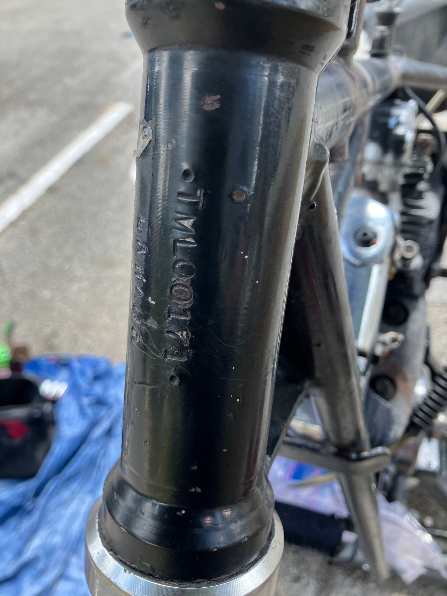

To me the frame looks OEM but I think it's a Softail Heritage with a Wide Glide rear fender and aftermarket front., Post up a pick of the right side of the goose neck of the frame where the VIN should be stamped in it.

I have stripped the bike down to just the engine in the frame. Once I removed the front end, I was able to see the numbers stamped. Not a harley davidson vin. The pictures show some number and Canada stamped. I was informed by the dealer that it was registered as an antique. Ultimately they are taking care of it and I will be given a title and registration. A little strange, but I do not care as long as I have the paperwork.

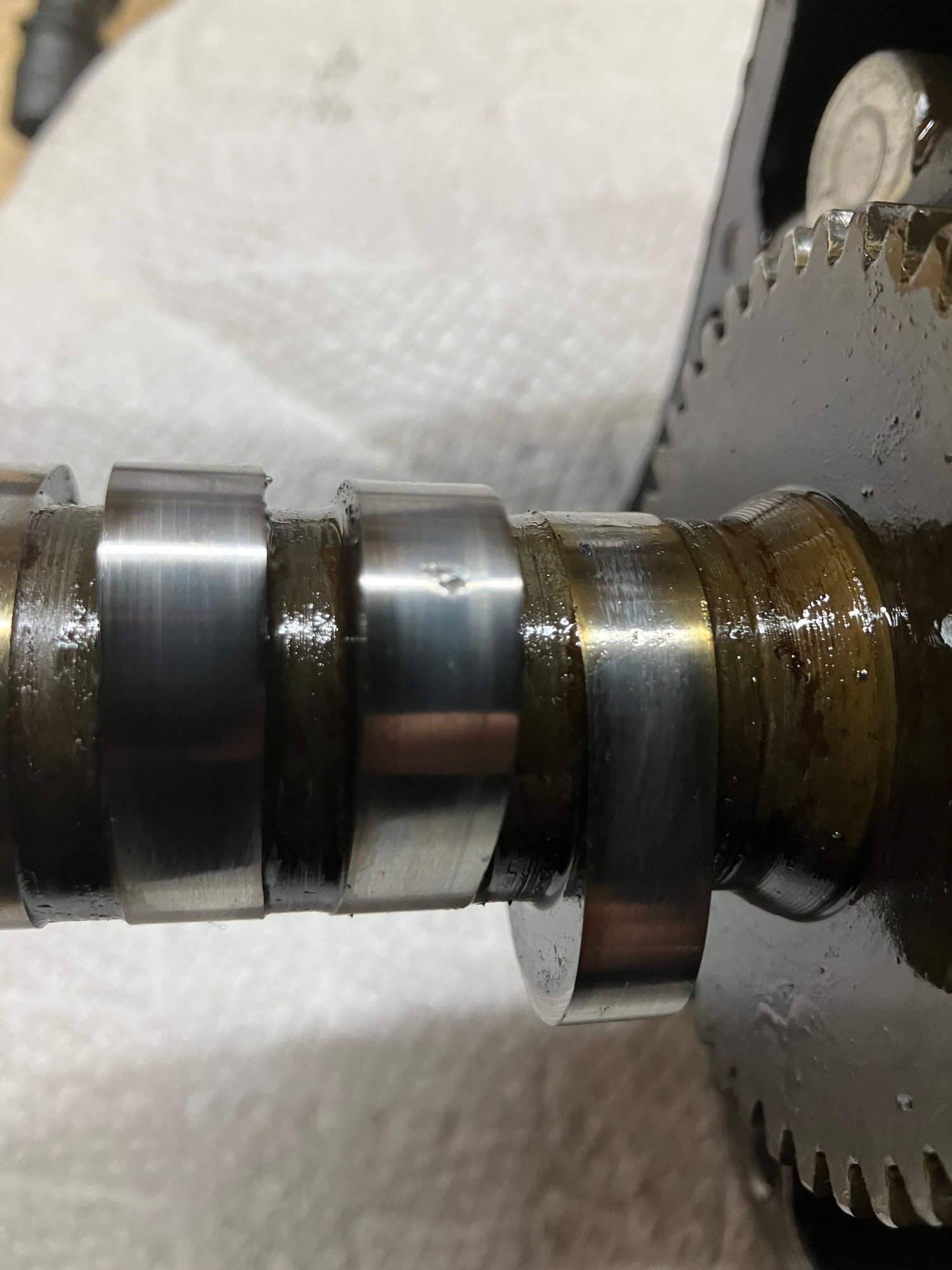

I am making numerous mistakes as I go along. I have learned to “READ THE ****ING MANUAL BEFORE YOU START DOING SOMETHING STUPID!”. I did not do the compression test or leak down test as 98HotRodFatBoy suggested. I will try to listen better to suggestions and advice. I pulled the gear case cover and timing gears out. This is where I should have read the manual and pulled the top ends off first. When I was pulling the case off, it would go so much and then stop like it was hitting something. Well I kept doing it as i was noticing that it was slowly moving so I continued until it pulled out. The part that came out not in any diagram in the services manual. It appears the lobes were hitting the rollers on the lifters slowly working past them by shifting itself/them? End result is a small nick on one of the lifters(see picture). If I had removed the heads and tappets first (LIKE THE MANUALS SAYS) this would not have occurred. The newbie is learning. Tomorrow I hope to pull the jugs off entirely and check the rods for any play. I hope not to have to split the crankcase.

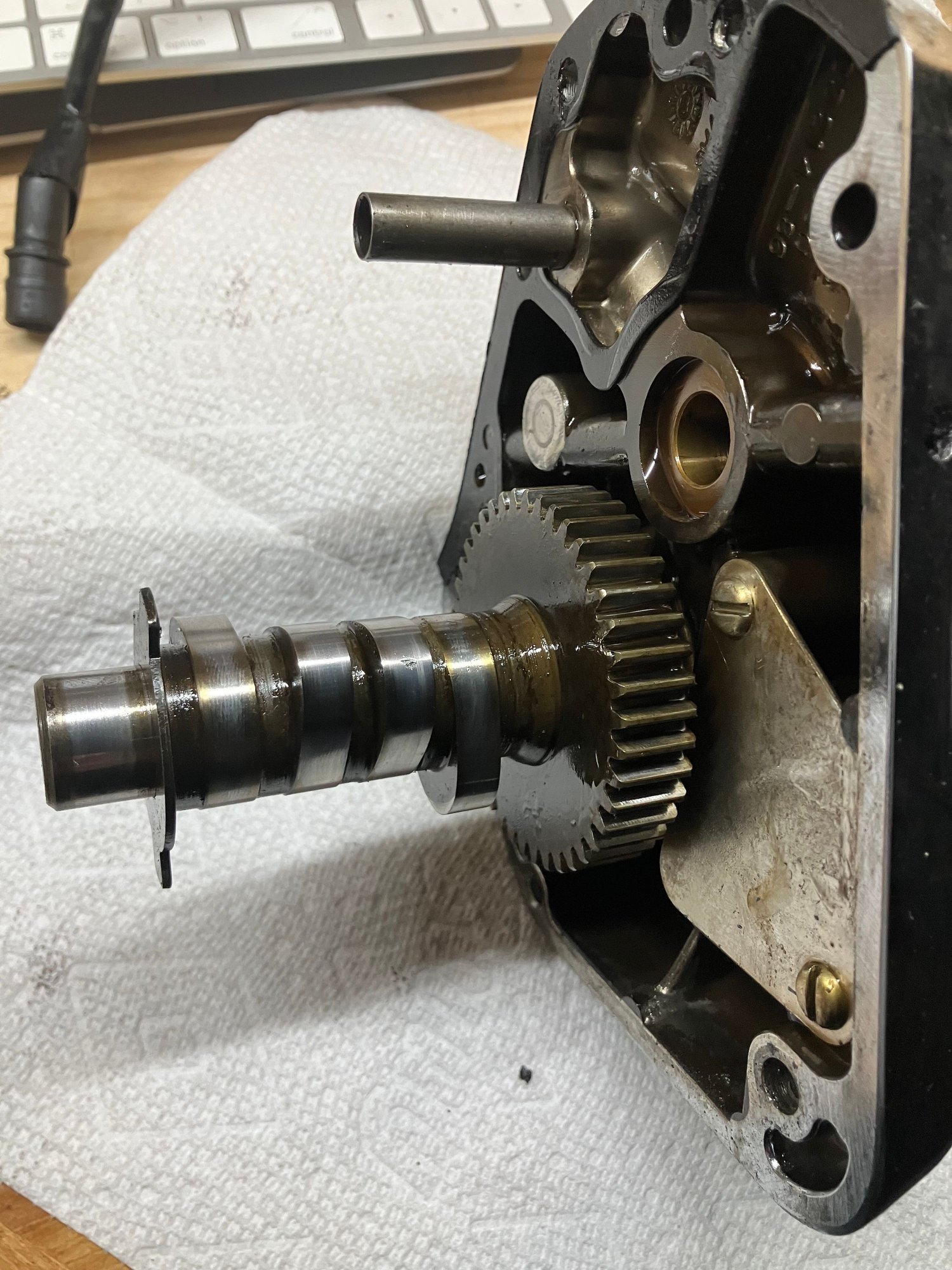

By removing the cam the way you did without removing the rocker assemblies first to relieve valve spring pressure on the lifter and cam, it's possible you might have damaged the can bearing.. You might want to replace the cam bearing..
I doubt you knocked the can love removing it but you will need a new one. What are your plans for upgrading the motor once you find out every thing that is in it?
On after market cams usually on the very end of the cam, the part that goes into the inner cam bearing there are identifiable letters and numbers. Can you post up pics of both ends of the cam (to include the face of the cam gear and better pics of the cam lobes) so we can help you to identify it?

As for frame, at one time, it did have a welded on factory plate on the frame, but that was ripped off, and other markings stamped into the frame. As stated, a little strange, but if seller getts you a FL title with it that way, then all should be good.

OK, I will be the guy form NY that says it.
Someone way back when called their bike into the Insurance Company as stolen and got their loan paid off. Then they bought aftermarket cases and a Canadian frame with a MSO and bolted all the stock parts back on. Then they went to DMV with some paperwork and got her registered as a "Custom" or "Special Construction" if your prefer. If happened so long ago, now the bike is old and can be registered as an Antique. Very common occurrence at one time in MC history.
Since you didn't do it and you have a Title, probably nothing to worry about. But I bet a beer that is her back story. Good luck with the rebuild.
