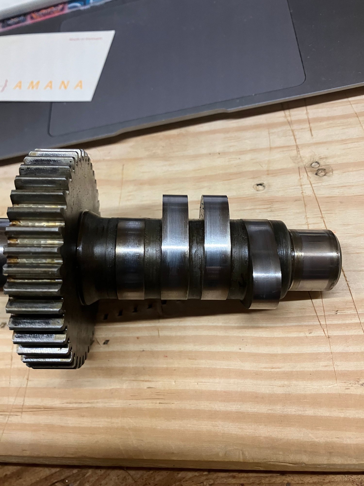

Old Mar 20, 2025 | 01:06 PM
  #33
rockjock729's Avatar
rockjock729
Joined: Mar 2025
Posts: 45
Likes: 13
From: Located in Florida.
Default Pictures of the cam
I do not see any numbers/letters indicating what this cam is.
Old Mar 20, 2025 | 01:16 PM
  #34
98hotrodfatboy's Avatar
98hotrodfatboy
Posts: 21,114
Likes: 7,638
From: Poolville
Looks like a stock N grind cam..
Old Mar 20, 2025 | 01:19 PM
  #35
Yankee Dog's Avatar
Yankee Dog
Posts: 3,727
Likes: 3,071
From: Brighton, MI
Looks like I see the letter "L". If that's the case it's better than the N cam but...
Old Mar 20, 2025 | 01:20 PM
  #36
98hotrodfatboy
Posts: 21,114
Likes: 7,638
From: Poolville
Correct.. They used that in 89 down. Better than the N grind..

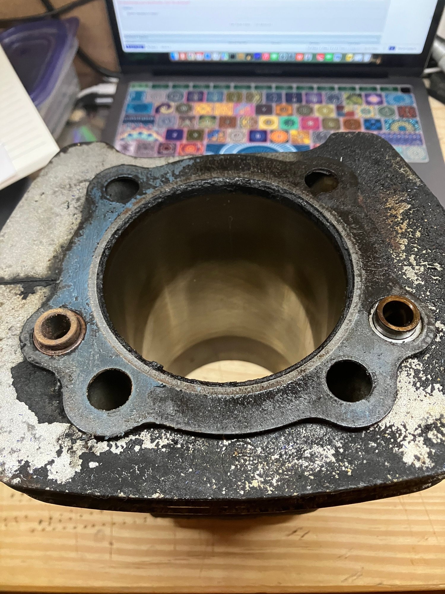

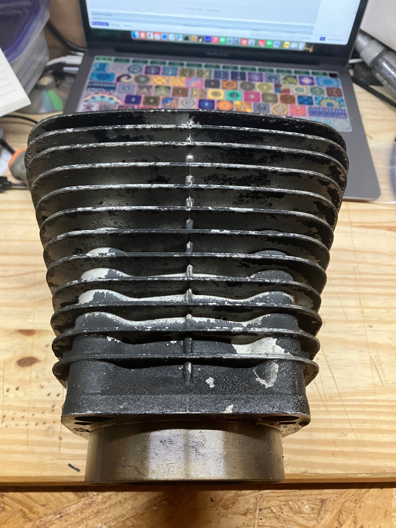

Old Mar 24, 2025 | 09:36 PM
  #40
rockjock729
Joined: Mar 2025
Posts: 45
Likes: 13
Just cleaning the jugs and top covers. The front jug when through an ultrasonic cleaning with wire brush cleaning after. The back jug has not had any cleaning done to it yet.
more cleaning is needed after ultrsonic cleaning.
Wirebrush applied.
Wirebrush applied.
