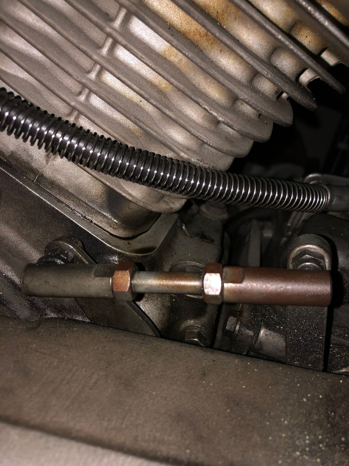

That little bit of oil that has pooled on the top of the case appears to have originated from weeping base gasket. This is two days sitting in the garage after being wiped off. The motor is a ‘99 “ crate motor “ put in my ‘85 FXRS. It has 44,000 since a top end was done at 100,000.
I’m wondering if just re-torquing the head bolts might resolve this or am I going to have to go further..? Any experienced advice is appreciated.
Btw.. what’s best these days for gaskets..? Been a while since I bought them.

I don't think tightening the head bolts is going to fix it.
I think if you tighten them too much you run the risk of pulling the threads out of the cases. When the bike heats up the aluminum cylinders expand more than the steel bolts putting even more stress on the threads in the cases.

IMO - Base Gasket Weep is a result of cold cylinder shrinkage resulting in slightly working the cylinder around the piston as the cylinder warms at startup. Paper base gaskets just do not holdup and once you torque head bolts and add the extra rotation it is not a good idea to add more rotation which will either stretch the stud or start pulling threads when engine reaches operating temperatures and head and cylinder are at their maximum thickness. (Coefficient of thermal expansion by material type)
I have had good luck with Genuine James Silicone Bead Base Gaskets. I believe the silicone bead provides the compliance to seal a cold engine and is soft enough to squish under normal operating temperatures.
Unfortunately you gotta pull the heads and cylinders to do it but in the end you get a peek at your cylinder hatching and new base & head gaskets. And the metal silicone bead base gaskets will not tear like the old paper gaskets at cold startup.
Genuine JamesCylinder Base Gasket (.017 in. metal/silicone) - JGI-16777-94 for Select Harley-Davidson Motorcycles

I can't speak for any other gasket than the ones I am currently using. Cometic single layer steel (SLS) with a very light dusting of hylomar. Been doing it's job since top end was redone about 4 seasons ago. I would suggest you consider having the cylinder bases trued up as MoCo never trued them from the factory. That goes a long way to making a better seal.
Along with that and letting the cylinders warm up (grow in length) before driving off/loading up the engine.

All the factory base gaskets were defective though careful warmup would extend life, they all leak with factory gaskets.
The current production OEM gaskets are totally different and will not leak. The current valve cover gaskets are silicone and fit perfectly. All others are too thick and can cause cover leaks.
They will jump in here and swear they use this and that with no problems. I have used all types in past but found OEM are superior to any other. I've always put about 12k a year on mine, more if I do road trips. OEM holds up..

Sometimes the base gaskets are so shot that you can re-torque the heads and convince yourself that you fixed it...but you haven't, leave them long enough and they disintegrate, the head bolts lose all their torque and you blow head gaskets.
A well-known MC brought an FXR to me once, because the head gasket blew, somebody (not me) had "rebuilt" the motor, put an EV27 in it and replaced all the rocker and head gaskets but not the original base gaskets, which. with 65K miles on them, were like oily cornflakes....I fixed the bike, they went to see the guy who "rebuilt" it....money changed hands...
