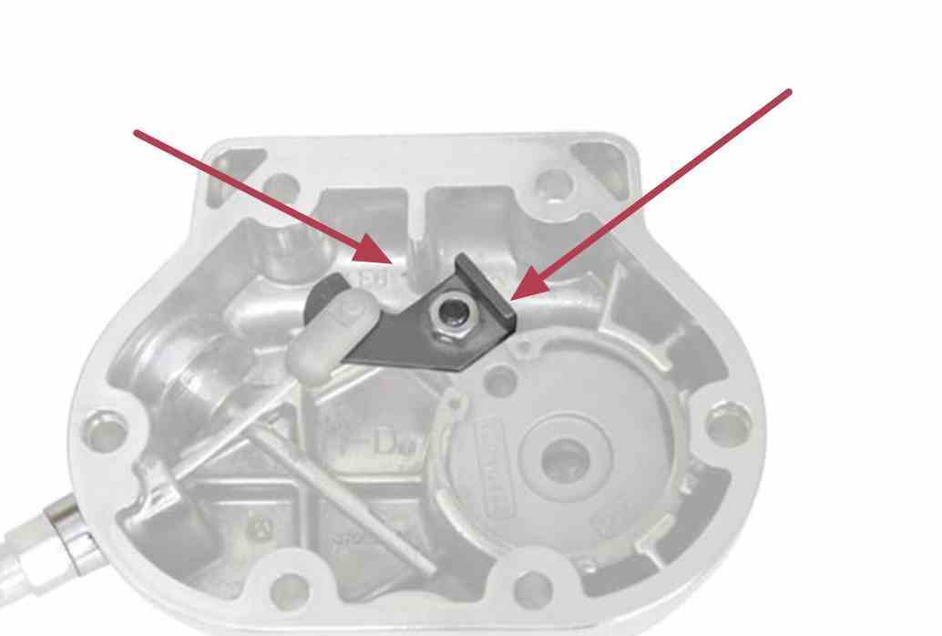

Currently 3 of my bikes have that arm in it and they work great. My FXDX has a 480 lb. spring. My 131 ci FXR has about 420 lb. Barnet scorpion and my 113 evo bobber has more than 10 springs in a BDL belt drive clutch. They reduce the pull by about 33%.. I make some mods that make them work better.
First the spacer needs to be about 1/2 the thickness. This gets you more threads in the tranny cover. Second I install the part and cut the shift fork pin stop until the arm with cable stop rotating clockwise (left arrow) when pressing down on the outer plate and allowing the arm to rotate. Third I check to make sure that the T part of the arm does not drag against the outer cover. (right arrow). Use 1/2 turn on the center adjuster.
The angle is only slight and I haven't broken a clutch cable yet. The FXDX gas about 50K with that config. The FXR about 26K, The 113 about 50K tho the cables were changed about 10K ago when I went to apes..
