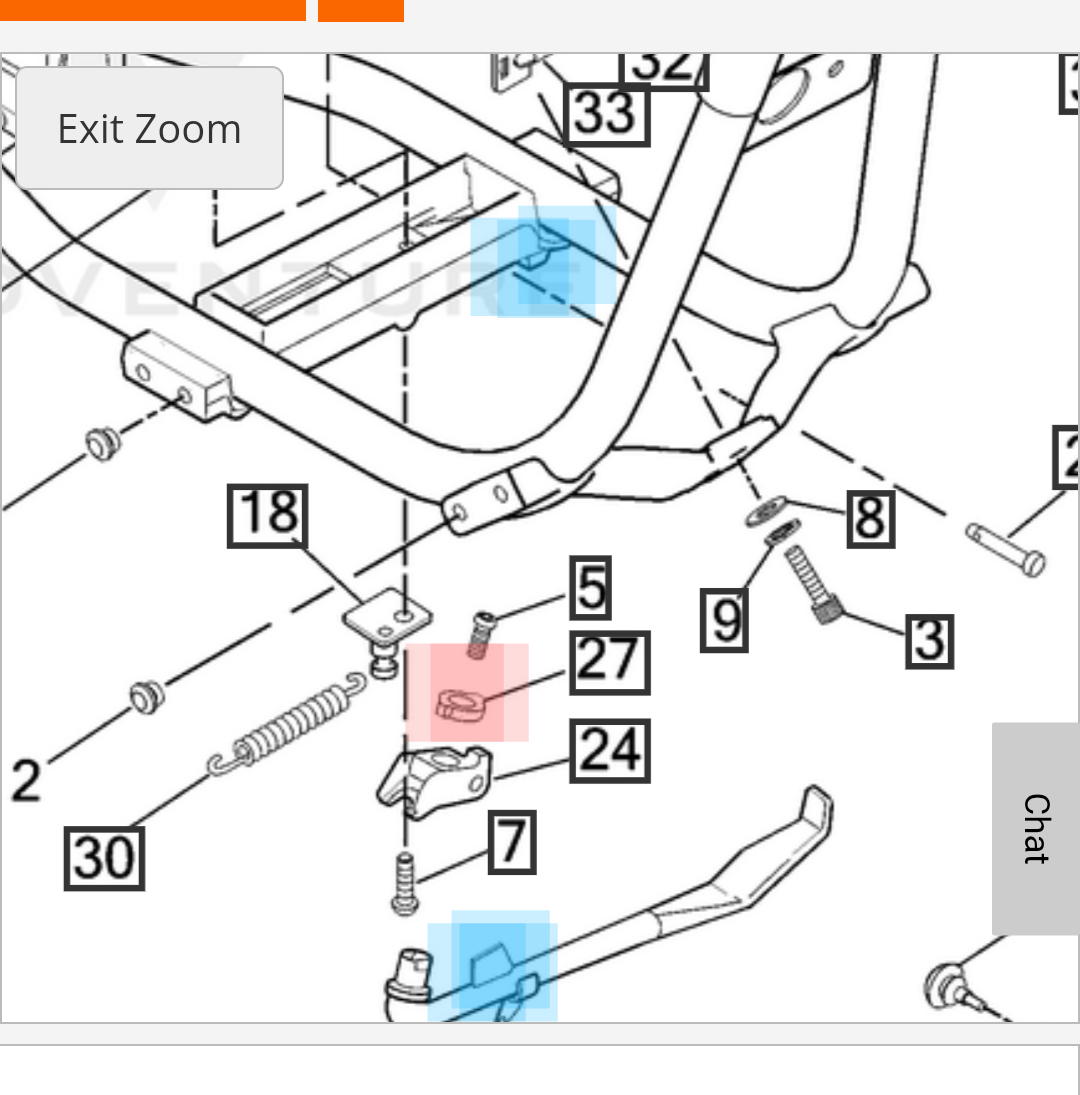

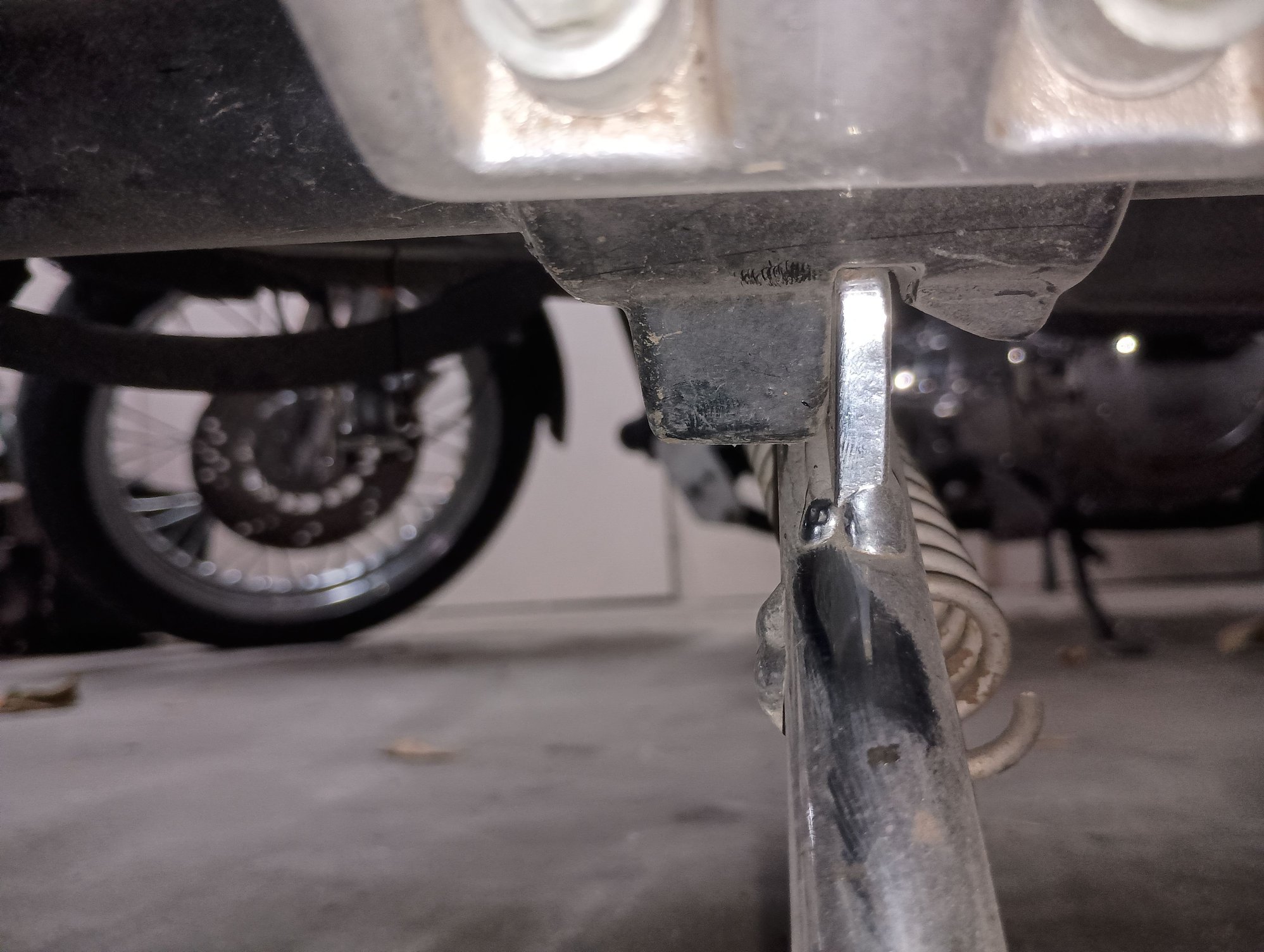

The first picture is of the busted catch that attaches to the top of the kickstand. It seems to be cheaply made by MIM (Metal Injection Molding).
Harley no longer stocks them. I had to go to eBay.
The second picture shows the kickstand blade securely locked in position.
By grinding down the blade when you deploy the kickstand the shortened blade will bypass the hard stop built into the frame relying on the cheap catch on the top of the kickstand.
When the catch on the top of the kickstand breaks the kickstand will travel completely forward upon deployment.
Red highlight is the catch. Blue highlights are the kickstand blade and the over travel stop on the frame.

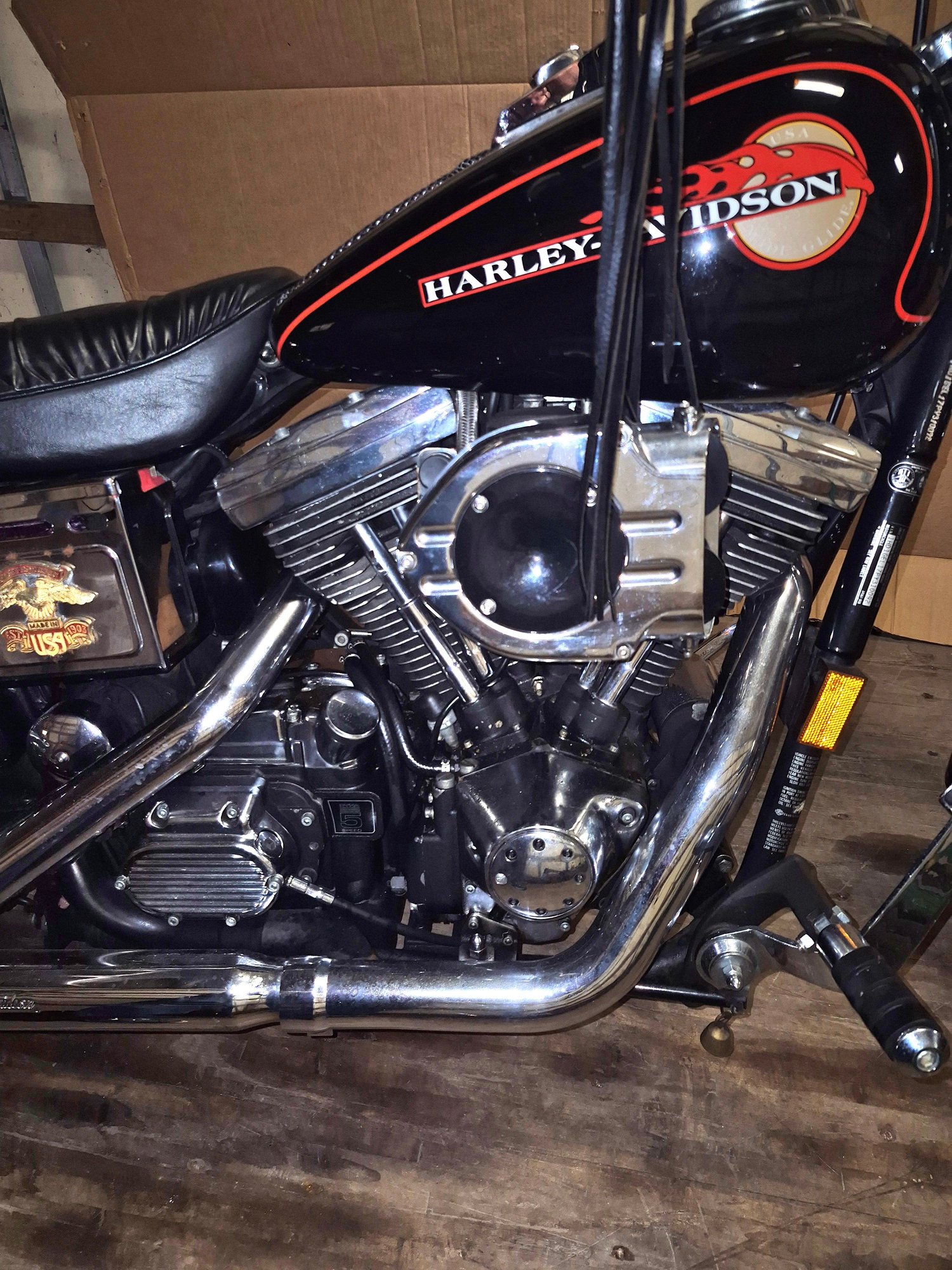

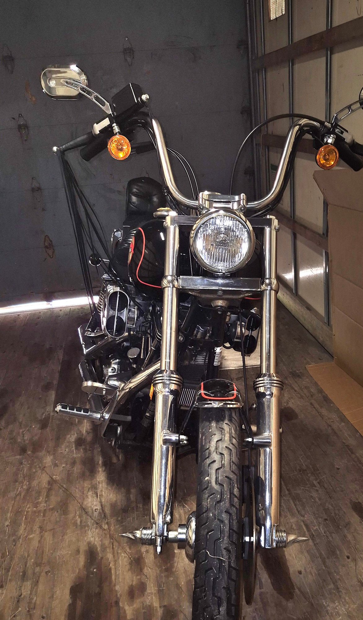

Here's some pics..

It looks a lot better than I thought it would
