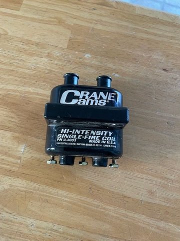

Default PROBLEM SOLVED
PROBLEM SOLVED BOYS!!! Bad coil. Put one from my shovelhead on and it ran perfect! I had cleaned a couple connections at the same time so just to be sure I put the old one back on one more time and sure enough, pop pop pop when I'd try to go WOT. What a relief!

As soon as you mentioned Crane, I had a feeling...
Been there, never again.

I ordered a Daytona Twin Tec to replace it, hopefully it lasts. The one I switched over from the other bike was an Ultima and it's been on that Shovelhead for decades.

I'm sure if you ohm out the primary side of the coil when hot you would see a reading not in the 2.6-2.9 ohm scale, causing the coil to not refresh quick enough for higher rpm's.. I assumed you had checked primary and secondary coil windings..
Cold on my bench it ohm's out at just over 3 ohms on each primary and 18,000 on the secondary. It must open up after it warms up, maybe I'll take a hair drying to it and see what happens.
