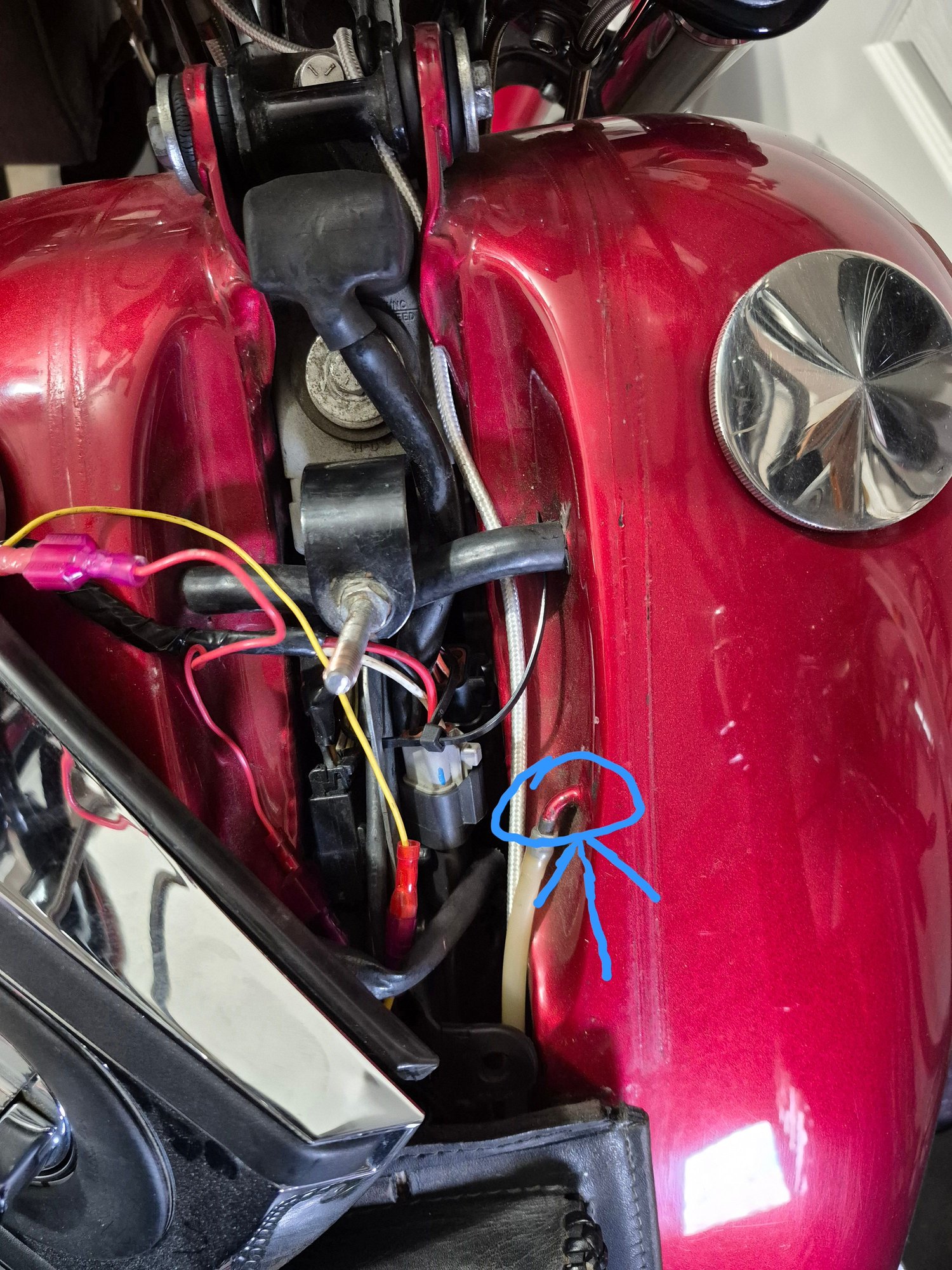

If you have the same tanks like I do, which iI believe you do, there's an overflow on the right hand tank and a cross connect between the two tanks up on to of the tanks.. Both can be located underneath the dash bezel.. The overflow (that i have circled in blue) also works as a vent so you don't necessarily need to put vented caps on your tanks.. I never have had vented caps and never had an issue

But...I do Not remember seeing a Left hand threaded cap, that was Vented..and I would Not want one on My Bike..unless I don't care about the paint!! Or...Maybe Never Fill all the way!!!!

Been that way since dual Tanks were invented... and No Worry at all..right side (Vented caps), are right hand Threads, while left tank caps, are left hand thread, (Not vented), ..as O.E....cant screw that up!!! But maybe the aftermarket, and some with a Better Idea, can..
Edit; While I admit, I have removed a Fuel Gauge..on an Accident...I have never managed to put a Left threaded Cap on the right ...nor Vice Versa.. would take some Determination me thinks

It's not an overflow. It's a vent. It allows the gas to drain equally between the 2 tanks. As racepres says, the left cap is sealed so that the left tank don't overflow when it's on the side stand.
