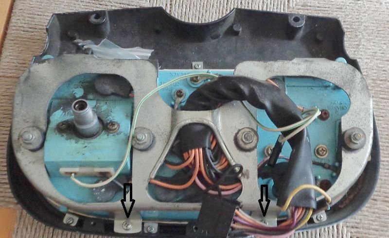

Yes, it's no problem. Take the odometer rest **** off with a #0 phillips at least 1.75" long.
Take the speedo cable off. Sometimes you can get it by removing the 2 screws on the rear, lift up and back. Otherwise you'll need to get it from underneath.
Pick it up and off. There is plenty length to remove the harness connectors.
There' a bracket that holds the instrument case to the top. Take that off and the guts will lift up. It may be stuck a little, be patient.
Do not take the lens off. Those screws can be tough and the rubber seal is n/a.
Much easier than it sounds, I can have mine off in less than 10 minutes.

There are 4 of the arrow screws and the whole bucket will lift up.

Remove 2 hex screws lower edge top panel, reach hand in unscrew speedo cable, remove 4 screws holding gauge cluster to underside of lens panel?

Take the odometer reset **** off All else you listed is correct.
Get that done asap. Water inside is not good. You said water underneath gauges (?) That blue box may be full. I woke up thinking about this...
