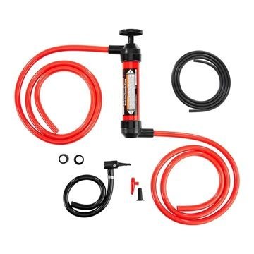

If it is running good, leave it alone.
If you need to drain gas out of the tank and do not want to mess with the petcock fittings, get you one of these at Harbor Freight for less than $10:
https://www.harborfreight.com/multi-...ump-63144.html

A little tough pulling the siphon hose out of the tank, but I’ve done it a few times.
Counterclockwise to drain, and remove screw?
O-ring could probably be found in an assortment.
