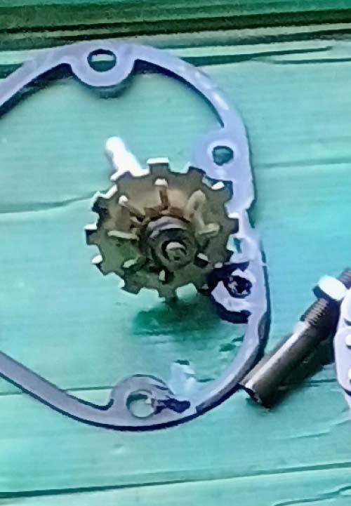

The only thing that's iffy is the clutch adjuster thingy:
But even it was tight (with the jam nut, that is) when I took this apart. Got a new one of those on the way anyway.

I dunno, Jeff. Slips, squeals and shudders. And you have a broken adjuster end thingie. I'm always one for fixing what is known broken, but I'd hate to have to tear it all down it that wasn't the only problem. I also seem to recall having issues with Barnett clutch sets over the years, so I always go with OEM parts. As I mentioned, I put all OEM parts in my bike about 20 years ago with an extra plate. My notes say "screaming eagle clutch." The original disks were right at the minimum wear thickness at the time, 66K miles.
So, back to slips, squeals and shudders. Sounds to me like something is out of round, that is, not flat. Plus the broken adjuster. But I'm guessing here.
