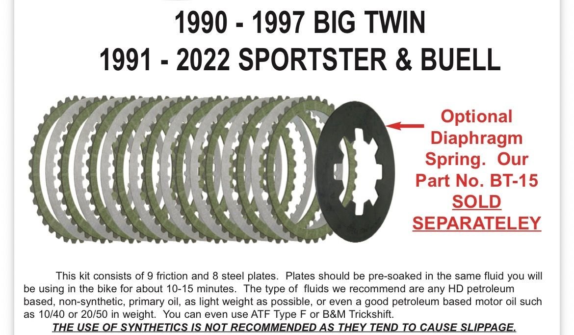

Originally Posted by Rains2much
Now I have research to do lol.
Got ya covered

Originally Posted by Schex
Got ya covered

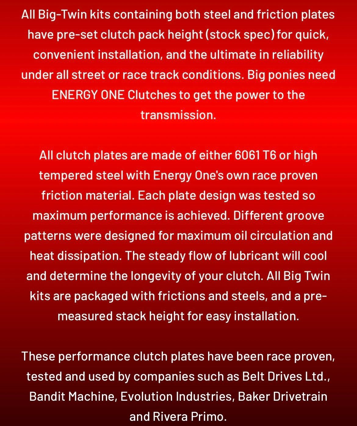

So I did some poking around and looks like energy one isn’t a clutch.. it’s the frictions & steels? If so I could give that a try. I did try the Alto and while it barley held in the 113Road king it didn’t at all hold in the 127 Softail wet or dry, just crap compared to the Rivera frictions.. But I could try the Energy one, actually a little cheaper.
Old May 11, 2026 | 03:41 PM
Schex's Avatar
Schex
Joined: Apr 2011
Posts: 5,817
Likes: 7,850
From: SE Louisiana
Clutch pack only, Evo industries basket, somebodies spring.
Alto holds a measly 125hp with spring and VPC for me just fine, 180 tire two up.
Both installed many moons ago.
Sorry you break stuff all the time.😆j/k
From the Energy One about info from the website, check the last paragraph.
