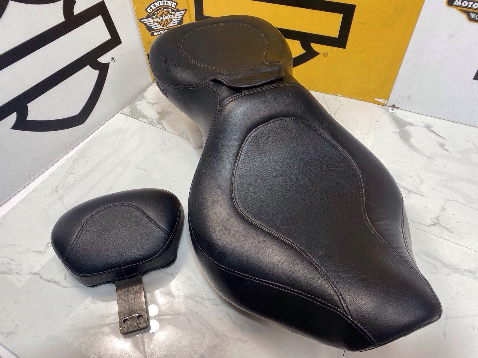

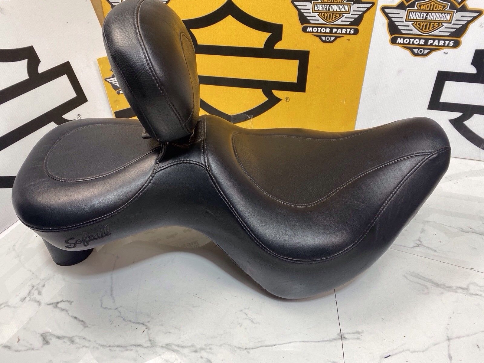

This is the seat I want, listed for a heritage softail

That's the one I'm looking at, I tried shrinking the pictures down but they still posted huge

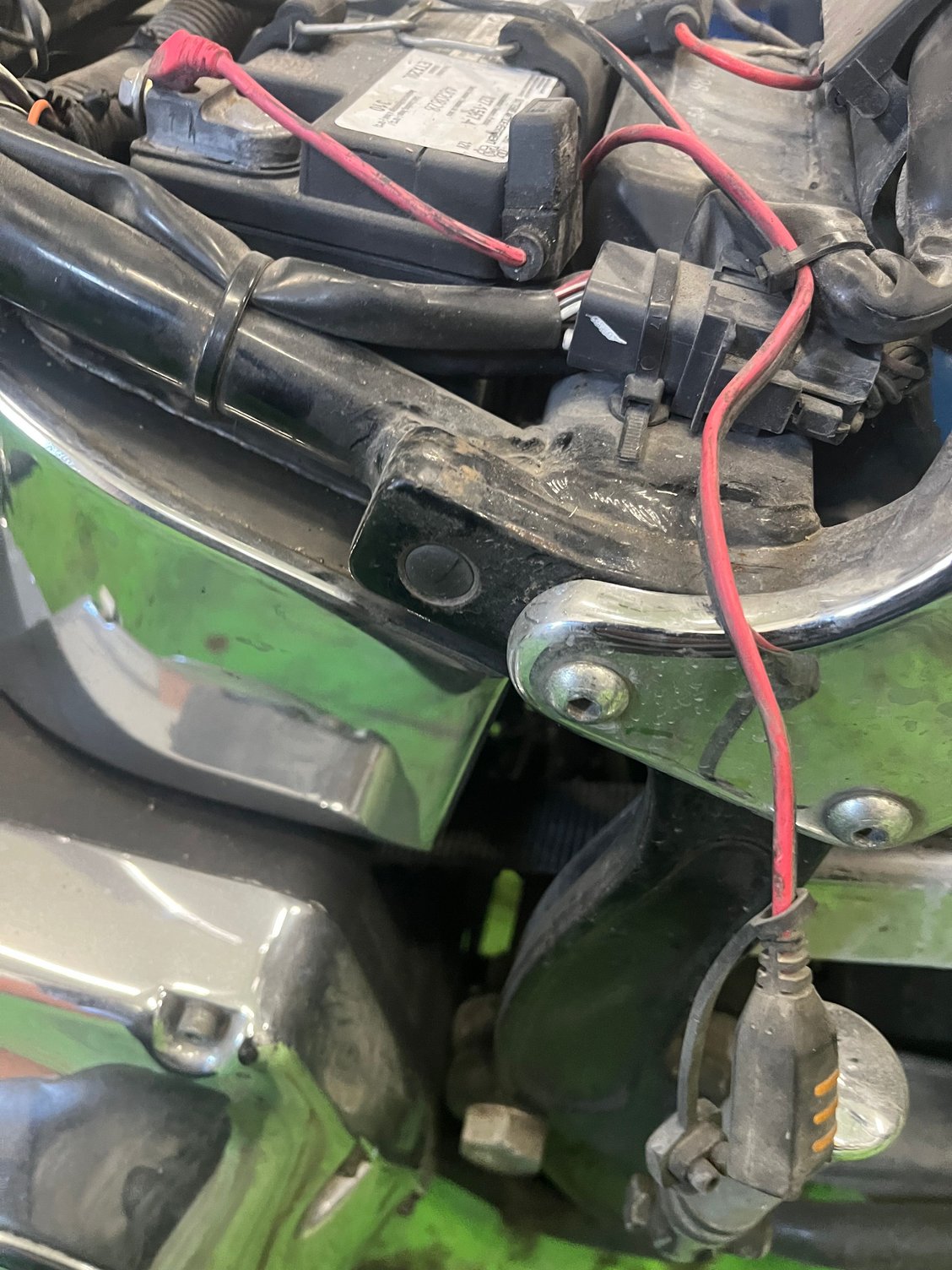

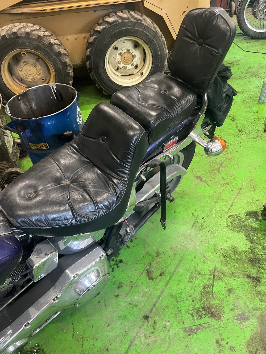

I was looking at my bike, I see those plugs, I was wondering if that's how the solo seats fit. Mine has the stock pillow seat that has a strap over the top that holds it down. The seat I'm looking at, in the pictures, is a stock Harley seat. My bike has the stock tank so I'm thinking this heritage seat should fit fine

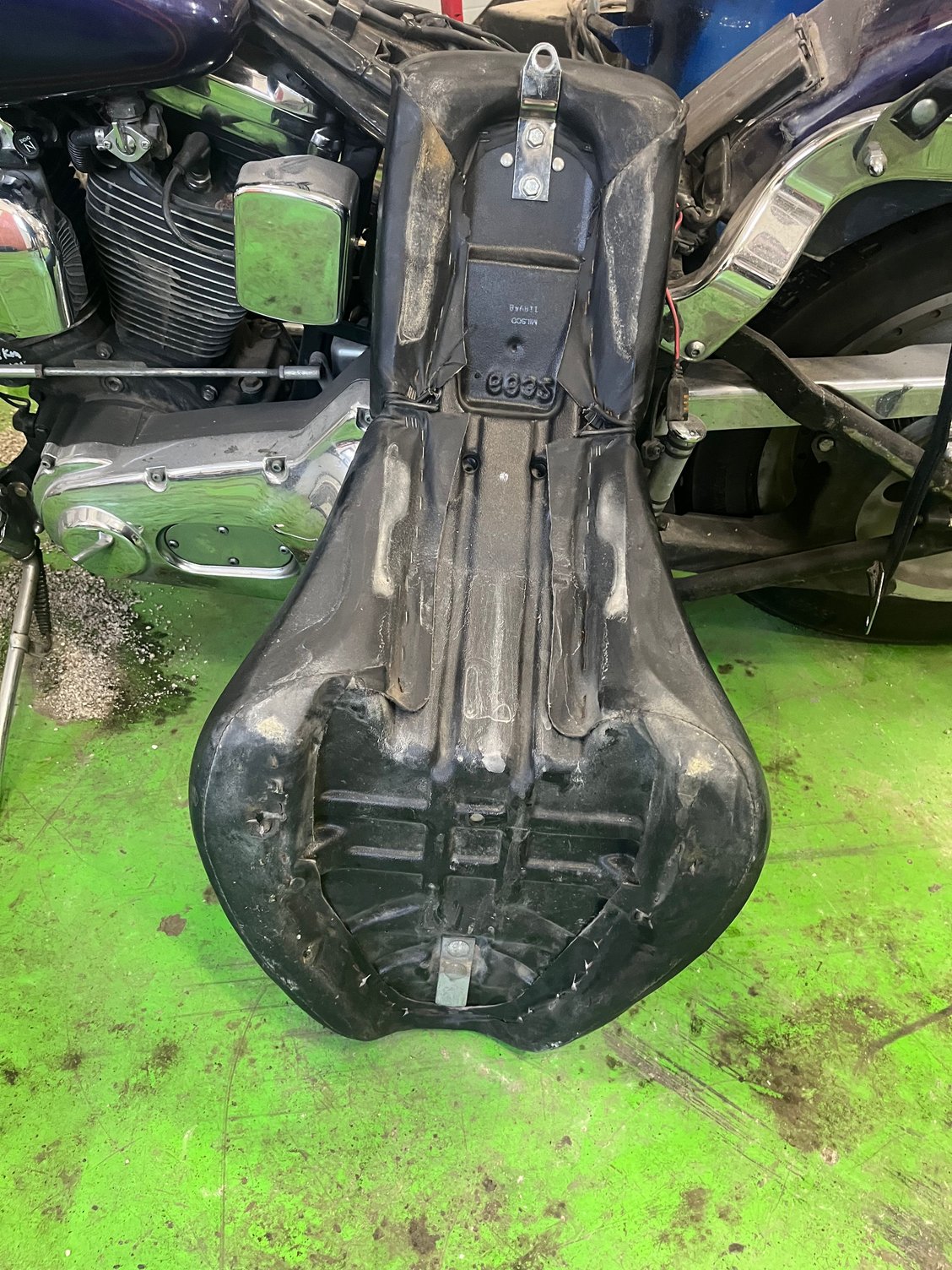

Stock seat on my bike currently

It looks like the new seat is missing the metal piece that lets you screw the rear of the seat to the rear fender. But it also looks like you could take that piece off your current seat and use it on the new seat.
Are the two "bolt tab" pieces that stick down on the sides of the driver seat removable?
Can you have the seller measure from the front tang to one of the bolt holes of that missing rear piece?
If it measures the same as your current seat, and if the two bolt tabs on the new seat are removable or won't cause a problem, it looks like it should work?

Pretty sure the bolt tabs will line up to the holes on my frame that have the plastic plugs in them. Seller “guaranteed” it’ll fit, but don’t they always? 😆
Yeah I’m thinking the same thing with the rear mount, I’ll take it off my current seat, or make a new one out of stainless steel. Consensus is that it’ll fit
