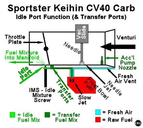

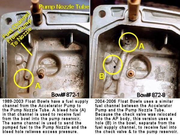

Carb rebuild time. Your idle and transfer ports are gummed up or clogged. Go here for parts: https://cv-performance.com/carburetor-parts
Images are from a Sportster CV40 carb but they are the same as yours.

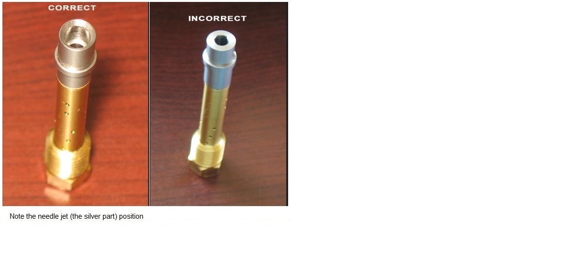

As previously noted along with the emulsion tube has lots of tiny holes, along with the slow jet, the smaller they are the easier they clog up.
Also, common error when rebuilding carb, see pic below.
