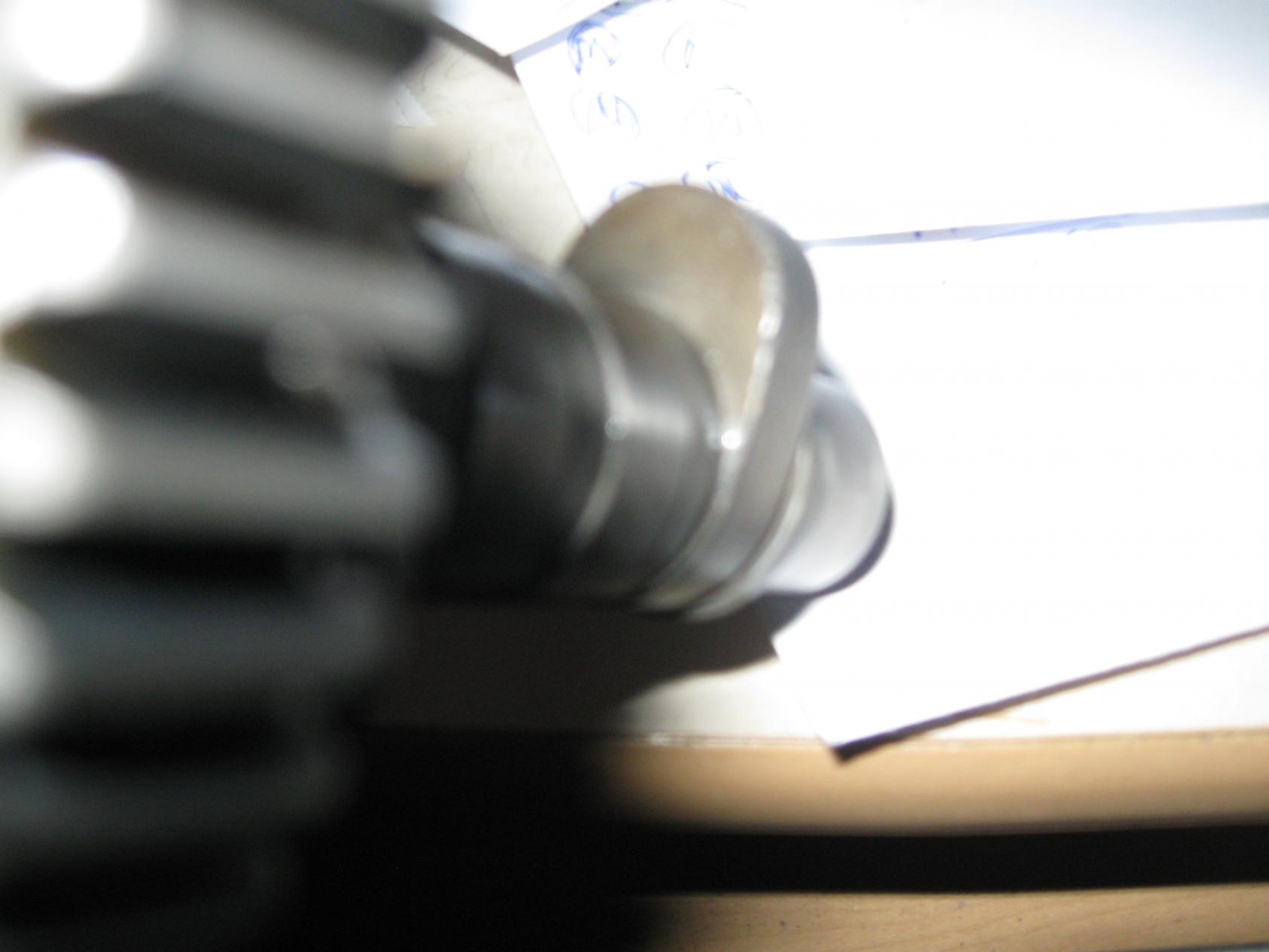

Originally Posted by 90hotrod
This is just an update of the problem on 7/18/13, 2nd time problem , w/my Ultima 127. Took a 20 mile ride, pulled away from a stop sign and started getting an engine noise, was (2) miles from home. took it easy. Parked it and never did anything w/it till about a week ago as I felt it was time to get ready for the 2014 season. Took it to a harley mechanic, 20+ years experience, had know reason to believe that it was not an easy fix, had not sounded like it did in '09 or about 4,000 miles earlier. Got a call yesterday, the engine is toasted. Did not get all the detail, will when I pick it up. Metal in both upper and lower, cam lobe bad, I can only imagine the oil pump and most every thing else is bad, as it was before. I will be bringing it home as is and try and figure out what to do. I am not at this point going to spend a bunch of money on an engine that has had catastrophic engine failure in less than 9,000 miles. I don't beat my bike and I keep the maintenance up. Over the last (2) weeks I have left Charlie, Ultima warranty contact, messages/number, telling him I understood it was out of warranty but I had questions. Have not received the courtesy of a call back. I am mad right now, Ultima supplied the parts last time but I had out of pocked expense and time lost on an engine w/appx 5,000 miles. Now I have a 350.00 expense to find my engine is fried, appx 4,000 miles later and a major out of pocket expense to have a running bike. I know that I bought a high performance engine, but my expectations were set higher than this and I know guys beat their engines and they just keep going. I will give Charlie another call and see if I receive a return call before I pass judgement on this engine and my experience w/it.
Payed the man for tearing down the 127, loaded the bike and a bunch of boxes w/engine parts and brought her home.His write up went as such "Main bearing making noise when rolling engine over by connecting rods.(2) tappet rollers failed. Tappet block broken, cam lobe wiped out. " Pretty damn close to what happened last time. Fed needle bearings into the engine and caused all kinds of hell. I don't beat this engine, I keep the maintenance up and let it warm up before I get on it at all. First time happened at 3,500 miles, it now has 12,000. I am going to try and get Ultima warranty to return my call, I called them twice in Feb, when it went in the shop, just to ask a question, wasn't interested in pursueing anything and the engine hadn't even been torn down, I didn't expect this again.
Considering this is the 2nd catastrophic failure in 12,000 miles I am going to ask for help w/parts, I already have a grand in rebuild and tear down. If I do not get any satisfaction I will not rebuild, I will either junk the engine and sell the bike or put a Harley engine in it. If that is the case I will not , at all , be an advocate for the Ultima engine and I think you can understand why. Included are some pics. Cam damage is kind of hard to see in my pics but the top and bottom edges are rough w/some little chunks out of the edge and the front of the lobe id rough.
Attached Thumbnails Ultima 127 problem-img_3431.jpg   Ultima 127 problem-img_3440_1.jpg   Ultima 127 problem-img_3437_2.jpg   Ultima 127 problem-img_3432.jpg

For some reason it appears you had a lot of side load on the lifter. This could be from a poorly machined lifter block (too much or too little clearance, wrong angle, lifter failure, etc.), excessive cam end clearance, was there a large shim on the engine side of the cam???? Also if the cases, oil lines, oil tank weren't super cleaned you will get repeat problems. Over the years we've had well meaning people rebuild their engines with a "friends" help and after the second time it exploded they would bring it to us to get it done.
Whe you pull an engine apart that has had a failure you need to treat it like an autopsy. Examine every part carefully even if you need a magnifying glass. If you aren't sure what you are seeing bring it to an expert or send photos to the parts manufacturer!!!
