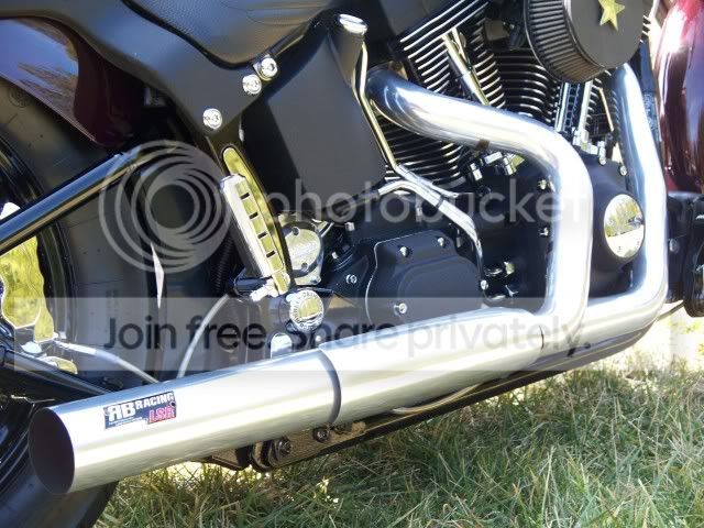

Jet Hot here also.Did the Sterling over chrome with no problems so far.With the ceramic the pipes actually cool faster.Wrapping them is a no no due to the condensation.The coating alone is fair,you need heat shields to make it really effective.You can touch the pipes in just a few minutes after running with Jet Hot's ceramic.
Those are really nice looking pipes! Interesting they they cool faster with the ceramic coating. My V&H dual headers stay too hot to touch for quite awhile - like 15 minutes or more.
