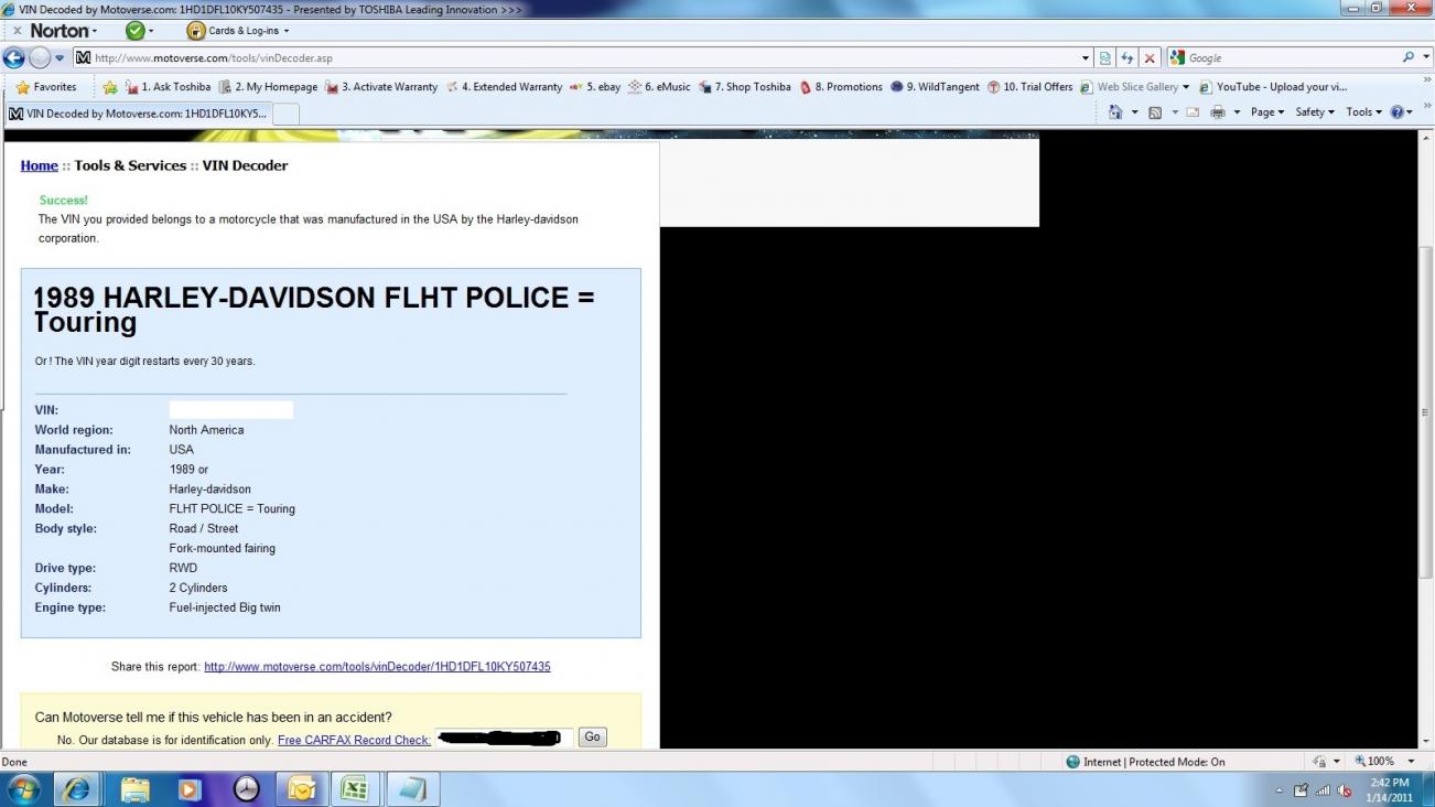

This website has a VIN decoder, which confirms my bike is a '1990' model. See what it says for yours!
In the case of exhausts, your original pipes, if they are still on it, have a flared end and odd clamp where the muffler bolts on. Later pipes have a simple set-up and will fit your bike, so you are not limited to 1990 systems. I have just bought a SuperTrapp system for mine and because it is a complete system it fits 1985-2006 models.

Thanks Graham a 100 times this really helps, although I put the vin in the feedback is a bit misleading as it says it is fuel injected which it is not it is carbed and although it says made in 89 it has 90 updates like the clutch and tranny.
Lynn,
Sounds like there may be a different rule for Police bikes! I know they had ABS long before we civilians were offered it. As 89FLHT says, these bikes are straight-forward to work on and sort out. If you get stuck there is plenty of help available here.
