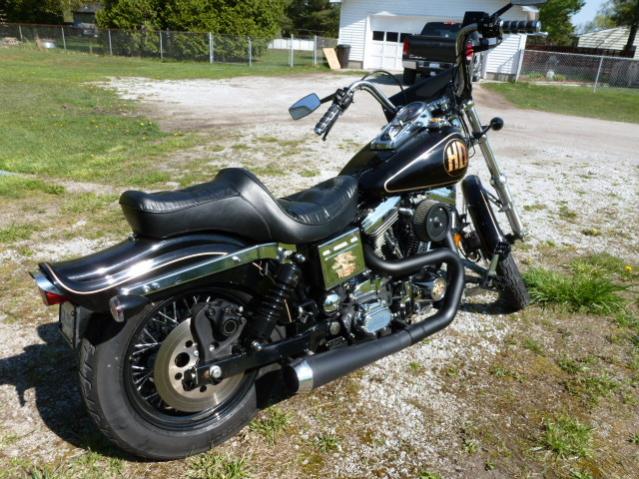

If you want a two into one with good sound check out the Bassini. I put a set on my 94 WG and they are the best sounding set I have ever heard, had supertrapps before and they made good power but the sound was not what I wanted. I don't have the part number but can find it if you are interested. Another plus with this set is that it is shorter than most..
