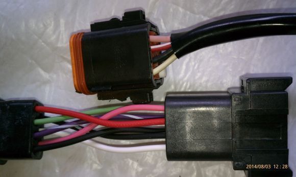

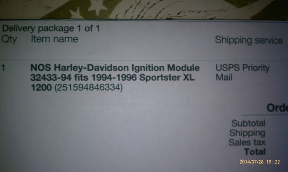

Originally Posted by kp877
Good luck man, let us know how it works out. I just ordered mine this morning. I tried to find others for you, but that was the only one I could find based on the chart. You could just order the harness adapter and save a couple bucks
Edit....I think the harness won't work either as the male female are reversed.
http://www.ebay.com/itm/151351115707
This is the one I ordered, the connectors are correct, hoping it works even though the wire colors different.
http://www.ebay.com/itm/131217484243...S:3160&vxp=mtr

I got the wire adapter, the basic colors matched up with some minor differences. My wires are all solid colors, some of the adapter and ign. module wire colors were striped. I plugged it all together, the bike started, idled and reved up fine. I'm waiting for a voltage gage to arrive and wired in to wrap this up and get it out on the road and see how it runs.
https://cimg5.ibsrv.net/gimg/www.hdf...3f4b4d19d6.jpg

Cool. So you could use the later style ignition module with the early style bike harness by using that adapter plug? Sounds good to me and I'll remember that.
The adapter worked fine, minor differences in some of the wire color. Not sure about the later style ignition module though, same year as my ride.
