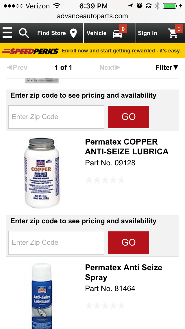

Advance auto parts carries it in some stores and online.
