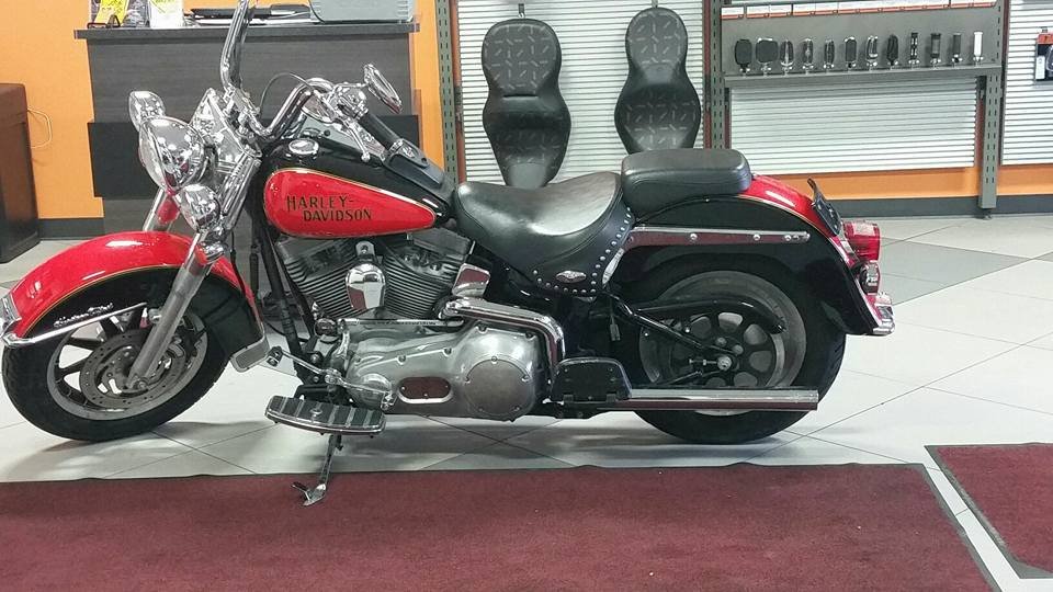

I have an 06 with True duals by V&H. I also have the Arlen Ness Intake and am using a Dyno Jet Power commander III USB.
I love the sound and they do work well. I agree that the PCIII is needed when you do intake and exhaust. I would also do it for exhaust only since it does increase the flow and I expect lean it out.
Here is air intake side. Mine is the one in Back and the SPortster is my Wife's
This is left side. I am planning to relocate the coil. I do not like it over the exhaust.
I hope this helps. I do love the sound. I did wrap the baffles in fiber glass to get rid of sound hi pitch pop sound that bugged my ears. That is subjective though.
