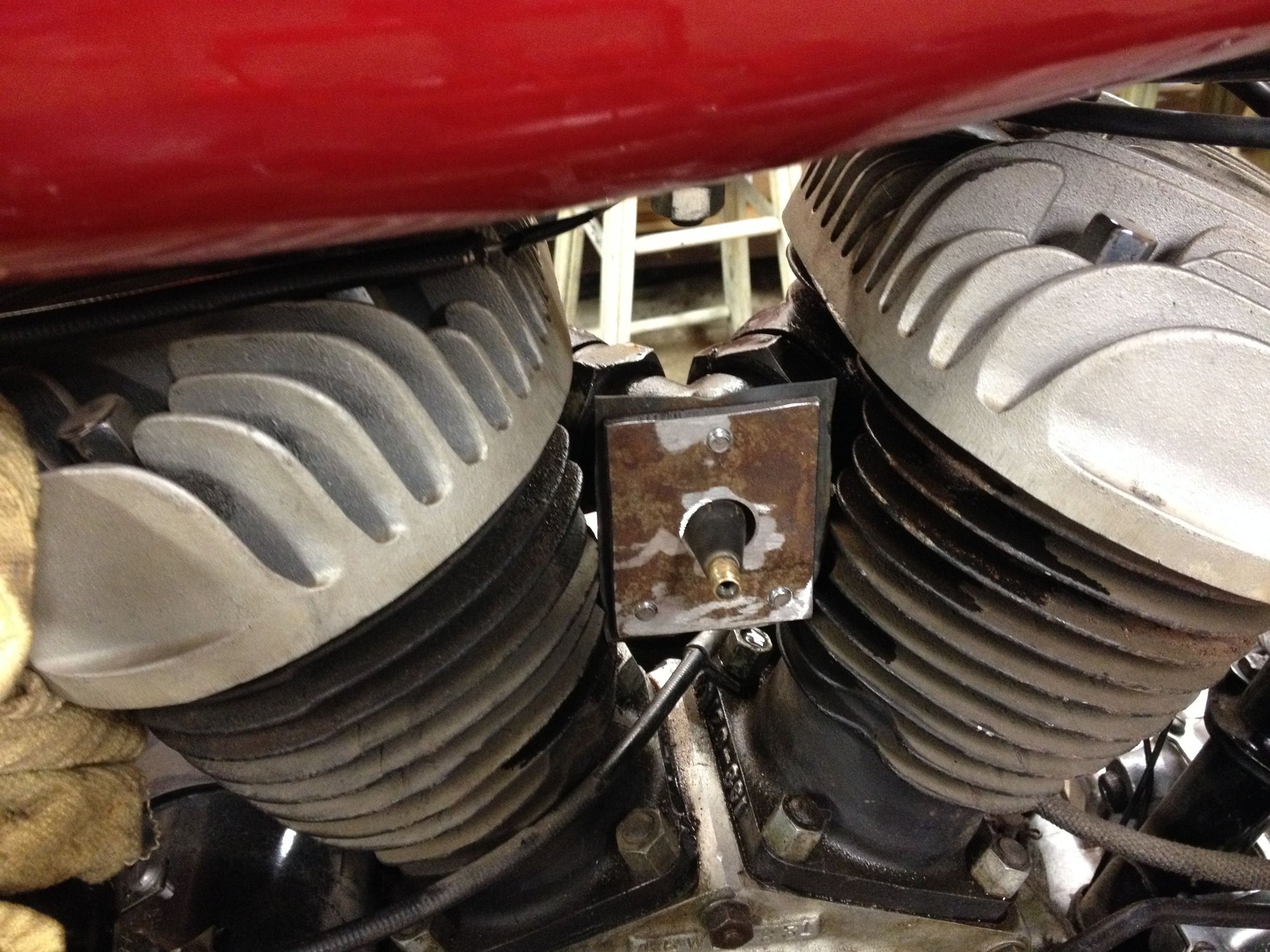

As John stated your issue is an intake manifold leak. PEEK seals should be ordered, then after installation you must do a bubble test of the manifold.
You may have a bad intake nipple causing a really bad intake leak.
Give this a read:
http://virtualindian.org/11techleaktest.html
You can buy a test rig or just make one. Good luck and report back to us.
Free rig I made from a steel plate and a left over inner tube. You will also need a regulator to set the pressure to 14.5 PSI.

Replace the seals with the PEEK, reinstall the manifold and then do the bubble test to see if you have a leak at any intake location. You may need to tighten the nuts more to get the bubbles to stop. You will also need to tighten them again after a couple of heat cycles. Normal with PEEK.
Nipple leaks are a maybe, they shouldn't be leaking but it happens. You do NOT want to change the nipples unless they are leaking. Otherwise leave them alone and thank the Milwaukee gods that they are fine.
PS you are over thinking the valves open and closed during the test, just put the rig on it with a decent regulator and get them up to 14.5 PSI. Then liberally spray soapy water all over it and look for bubbles.
