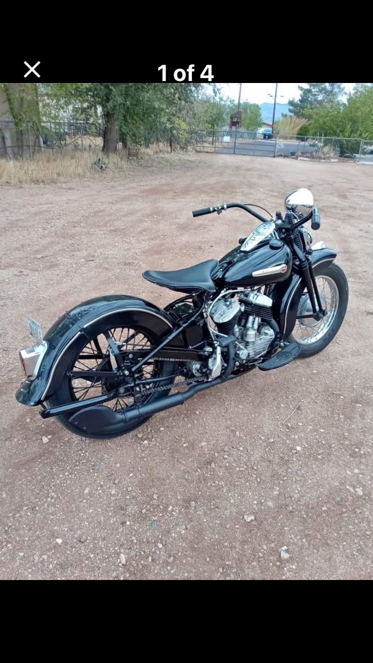

Here’s Wilma. She’s got ’60 GL cases (titled as a ’60 with an AZMVD-issued VIN) and a GL clutch pedal (which is perfect for my wrecked and rebuilt left foot). Frame, trans, front end, etc., are ’47-’52. Engine and trans rebuilt by an old feller from a reputable shop. She has repop fenders (front having been bobbed tastefully, IMHO) and a few other repop parts. Heads are actually cast iron GL ones that were painted to look like the WL aluminum ones. Frame and other parts have been powder-coated. Front wheel and brake are a dual-leading shoe set-up off an old Suzuki DT. I had considered chasing down the original, but I am going to just get the parts powder-coated to match the bike. Reason being is both cost, and the fact that this thing really stops well with the upgraded brakes, and I like that. Definitely not an “original” bike per se, but she was built well, and the price reflected her level of originality…I’m not in this to go to shows, win trophies, and have a numbers-matching original ride…I’m in it to ride and enjoy (that, and I didn’t have $12-$50k laying around to spend on a bike, lol):

Thanks. Although I’m a seasoned motorcycle rider, I am taking my time getting used to this, as she’s a completely different animal than any BMW, Triumph, or Japanese bike I have ever been on.
Quite frankly, I love her thus far, and that Servi clutch suits my beat-up left foot (I had to sell my ’73 BMW R60/5 because I had problems ridng it, and they are not easily modded like Japanese bikes by simply moving the shifter position and/or installing a heal-toe).
I feel like my interstate riding days are behind me, anyway, and I’m looking forward to some mellow two-lane fun.
Literature on the way so I can begin to know her inside and out, as well.
