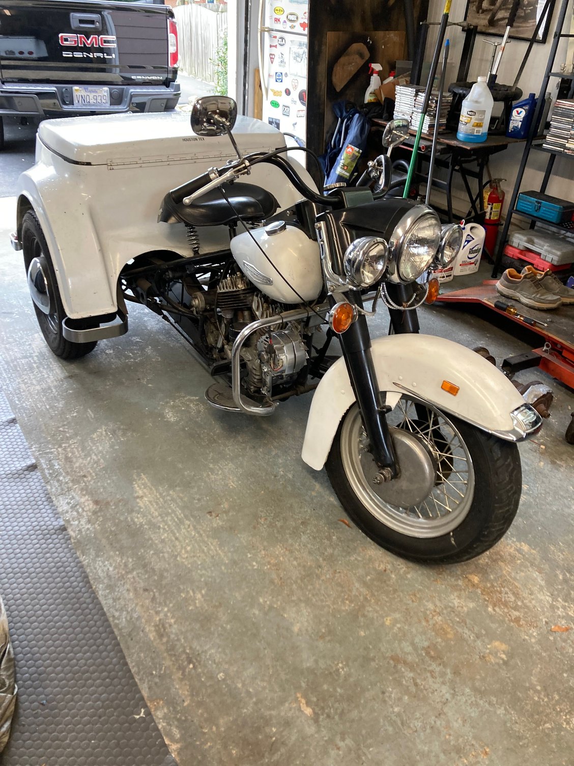

I brought home a 1969 HD Servi a few weeks back and have been adjusting to the learning curve of Flathead 45 and Three Wheel Ownership. It is an X Houston PD machine and showing 26K on the clock, of course that can in no way proven to be actual. It starts and runs decent but handling is another issue. It has a death wobble at speed that puts any Jeep I have ever owned to shame. I have improved it somewhat by playing with tire pressures and the steering damper. Currently it is in the process of getting a new front tire since the one on there is pretty worn and cupped. The head stock bearings appear to be in good shape just from a visual inspection, there is no play or rough spots no matter what the damper setting. The forks have good movement and I have not changed fluid yet after checking on how much of a fun experience that is, but that is on the to do list. I am hoping the new front tire and a static balance with probably 5 or 6 pounds of wheel weights will help but any suggestions or comments from other Servi owners would be greatly appreciated. I have to admit, ownership of this damn thing is the most fun I have had in long time with a motorcycle. There are a few other vintage bikes and my small garage and it is like I brought Baby Huey home from the cartoons concerning room, but we will adapt. I am looking forward to contributing when I can as a new member and gleaming as much information as possible from you guys........George

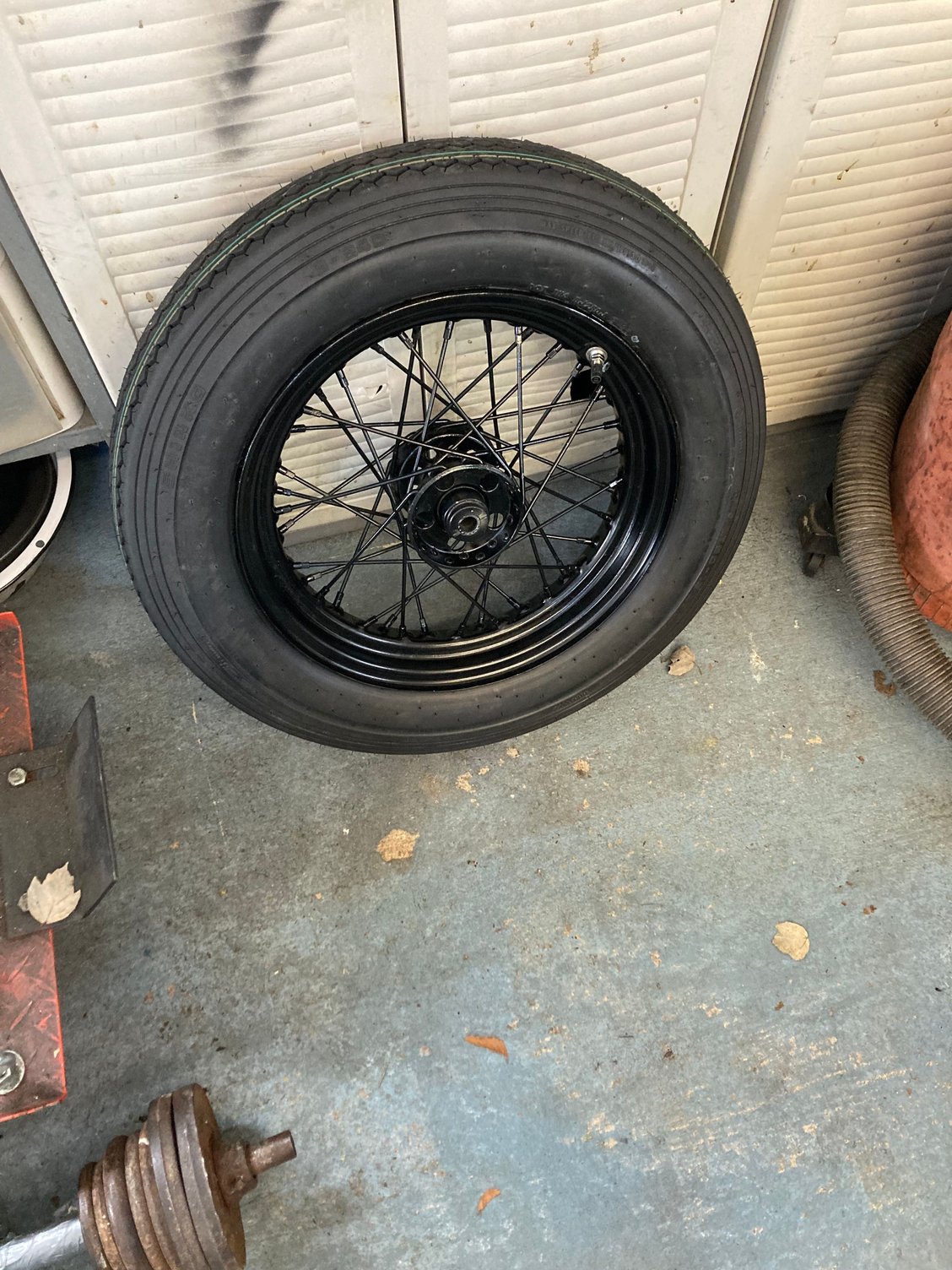

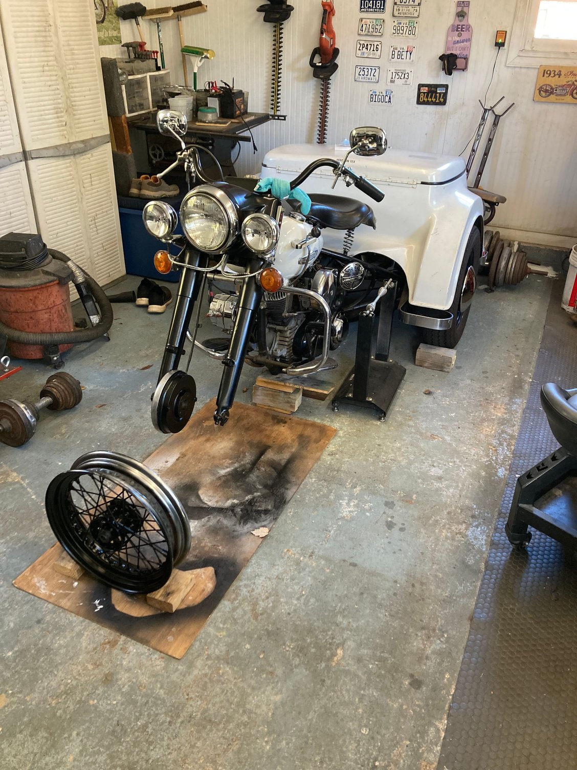

The Shinko 270 looks pretty decent as a Servi front tire. I also painted the wheel black to match the rear wheels and eliminate a poor rattle can aluminum finish. Just had to touch up the brake drum allen bolts while I was at it. Going to try to get a good static balance and bolt it back up next week to see if there is any improvement in handling.......
