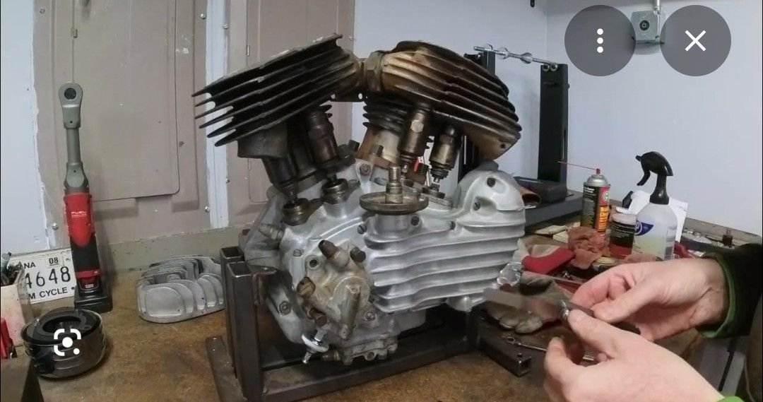

I interestingly, there not a lot of pictures on adjusting the valves on those flat head motors.
Are you under that fat pushrod cover tube like this? So that's the cover your screwing into the tappet boxes.
