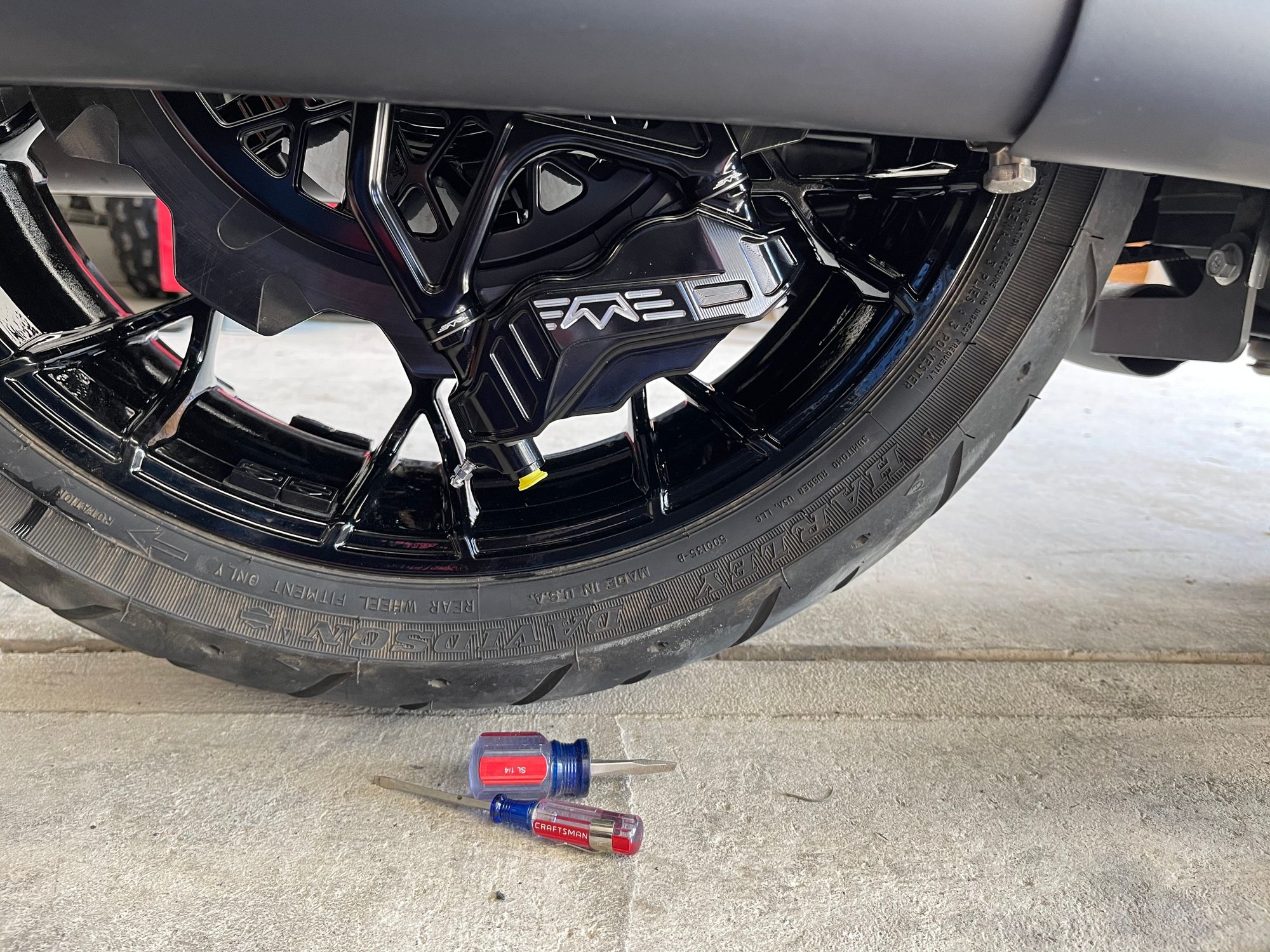

Putting on a rear radial caliper and need a longer brake line. Anyone know a good source for a good brake line? Also the side that mounts on the ABS block the fitting is a square. Harley told me they use that so they don’t spin when tightening. Not sure if I can go with a regular fitting like mounts in the actual caliper. Pic for attn. any help is greatly appreciated thank you.

so much black, everything blends in, eyes not what the used to be. maybe enhance the jpep with circle of area or diff angle. russel products make all sorts of brake components.

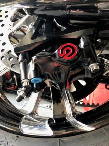

I just put a 108 mm Brembo rear caliper on my softail. I used a Kraus adapter bracket. Today I ordered a SS braided line with 10 mm banjos from Spiegler. The banjo at the ABS unit is square but its a 10 mm. I dont expect a problem bolting on a round banjo to the ABS unit

Today I ended up taking the bike to the dealer to bleed the Spiegler rear line and cycle the ABS unit. Although I am taking it easy on the rear brake until the pads are bedded in, I do notice a big improvement with the Brembo radial 4 piston caliper over the stock setup. Pricy, but now I have an acceptable rear brake.
