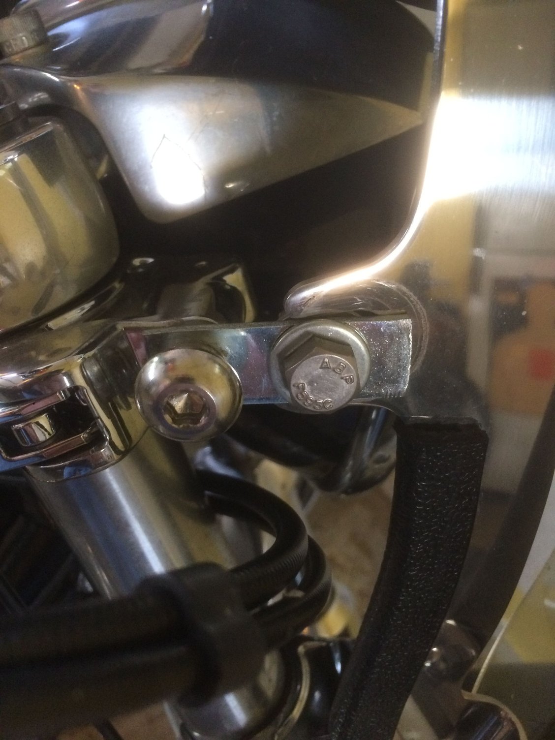

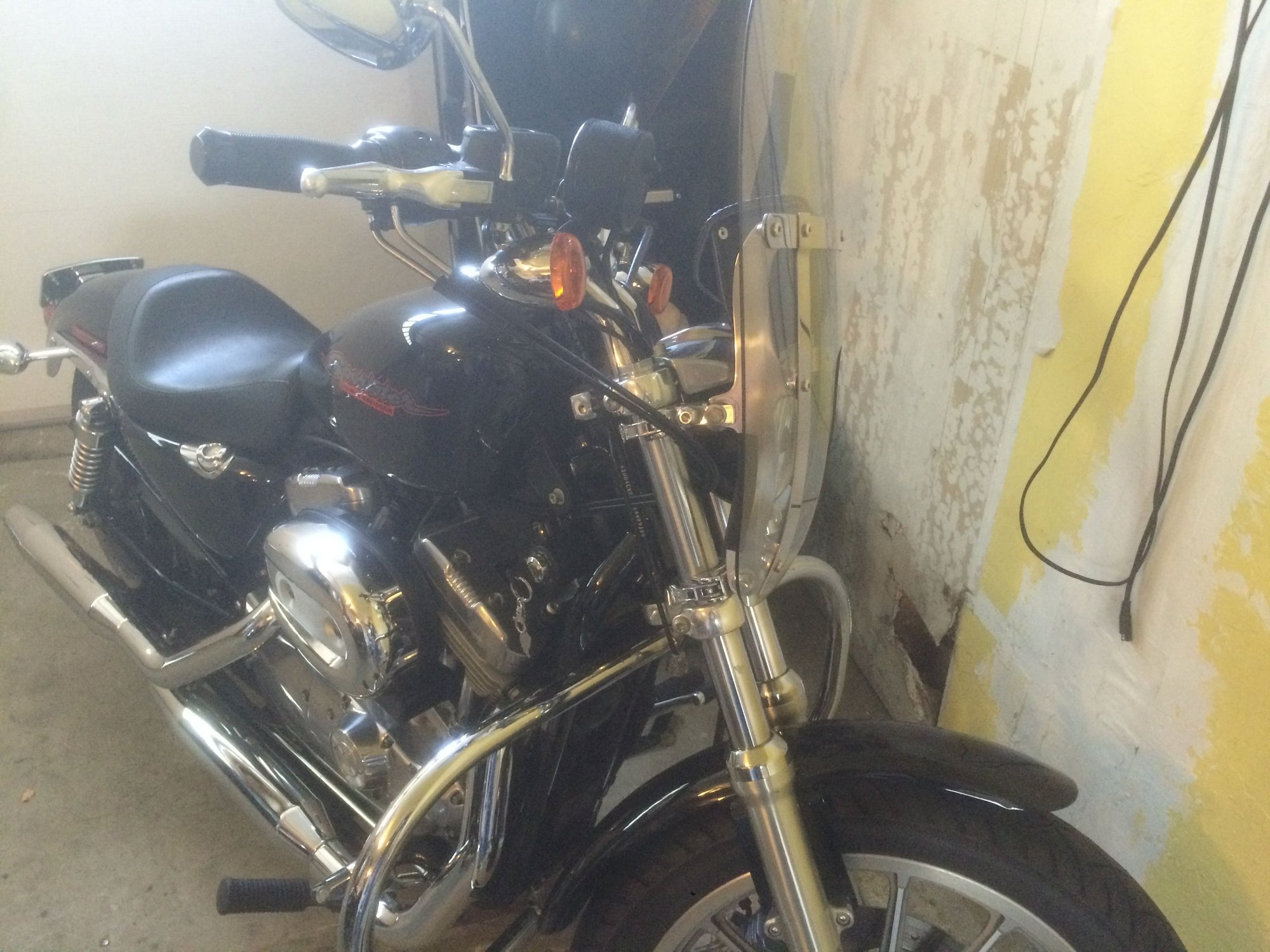

On my wifes sportster I added 2" "mending plates" to arch the top of the windshield forward so the buffeting air goes above her head. I had the same set up on my dyna and it was very effective. I changed my front end to accept road king hardware and a softail shield so the quick connect hardware went away on my bike. So plan B (PVC) went into effect. You may want to give the mending plates a try-available near the gate hinge area of your local hardware.
