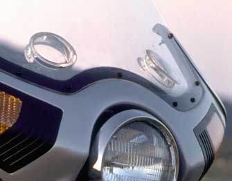

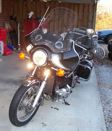

that's thinking outside of the BOX...
I remember back in the 70's when I had WindJammer Fairing that had came with two Holes/Vents in the shield that could be adjusted to relieve the Neg Pressure to help with buffering...
Heres a couple pics as what they looked like back then
You can still find those vents at aviation shops.
