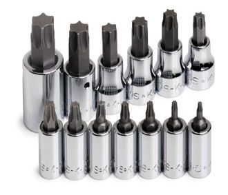

I'm putting different rims on my ultra and need to remove the rotor on the rear wheel to be able to install it on the other rim. I have tried the impact star bits that I bought at Advance Auto and they immediately broke off. Is there something else I should be trying or is there a trick to this? Thanks

Snap on.
I've twisted my Snap on star bit but they fixed it for free.
Sometimes I've had to use a hand impact with a 4 lbs sledge to get those bolts out.

Heat the heads of the bolts with a propane torch first. That will melt the Loc-Tite that's holding the threads that are breaking your torx bits.

And..I believe those bolts are one time use. Get new bolts for the reinstall.

I've come across some really stubborn ones over the years, I usually weld a nut to the head of the bolt and use an air impact to get them out.
The heat of welding certainly helps the process.

As stated before heat the heads a bit with small torch or big soldering iron if you have one if not try this method. Put the torx bit on a breaker bar and apply steady even down pressure against it while holding the socket in against the bolt head, It may not move immediately but continue to hold heavy steady down pressure and the bolt will break free after short period. I have yet to strip out a bit or damage a bolt since I started doing it this way, all the impacts and sudden banging do it distort the bit & bolt head.
