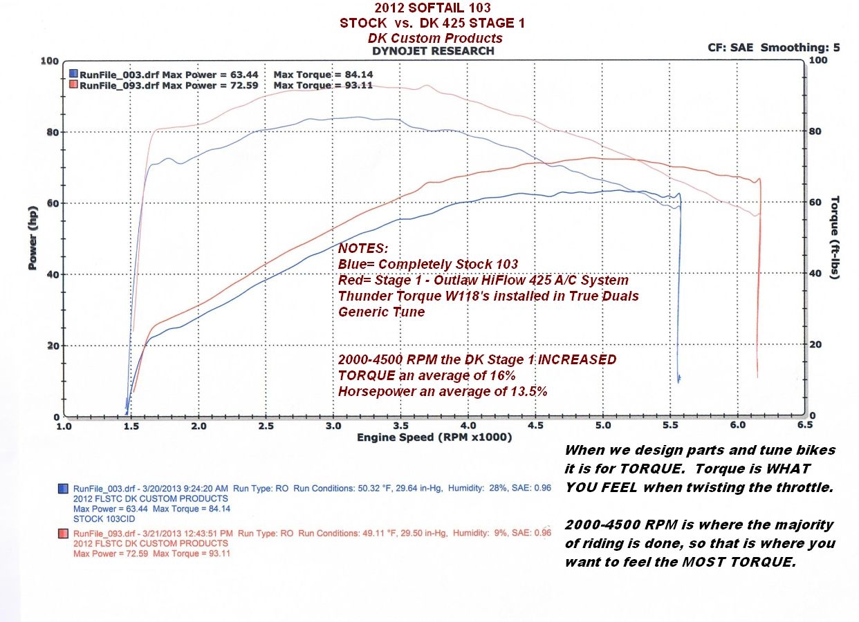

Originally Posted by didav-oz
hi there, I am not liking the gearing on my 2015 Heritage Softail especially 1st gear, I know the stage 1 (with cleaner and full exhaust replacement and tuner) wont affect the gearing at all, but I am wondering if the engine will rev more freely in first gear and have more low revs torque in second gear so I can corner at low speed without having to change into first gear, which currently I find annoying for low speed cornering. I ride 2 up all the time so I just like to chug around when riding the neighbourhood. Any real world advice will be appreciated, because I am considering trading the bike on one of the Rushmore Project bikes that has taller gearing, david and dianne, Victoria Australia
There are so many different ways to go with a "Stage I". Most will get you more low end torque. Many will be very expensive. Many will make your MPG suffer. Most will make it run better at first, but as time goes by, you will slowly lose much of the initial improvement.
A good Stage I will give you more torque, not just in the low RPM's, but all the way thru the RPM band, will increase your MPG, will run cooler, and will increase the longevity of the engine.
Here is a Dyno Chart of a good Stage I on a Softail Heritage-
You can see more info on the difference between most Stage I's, and good Stage I's at this LINK
