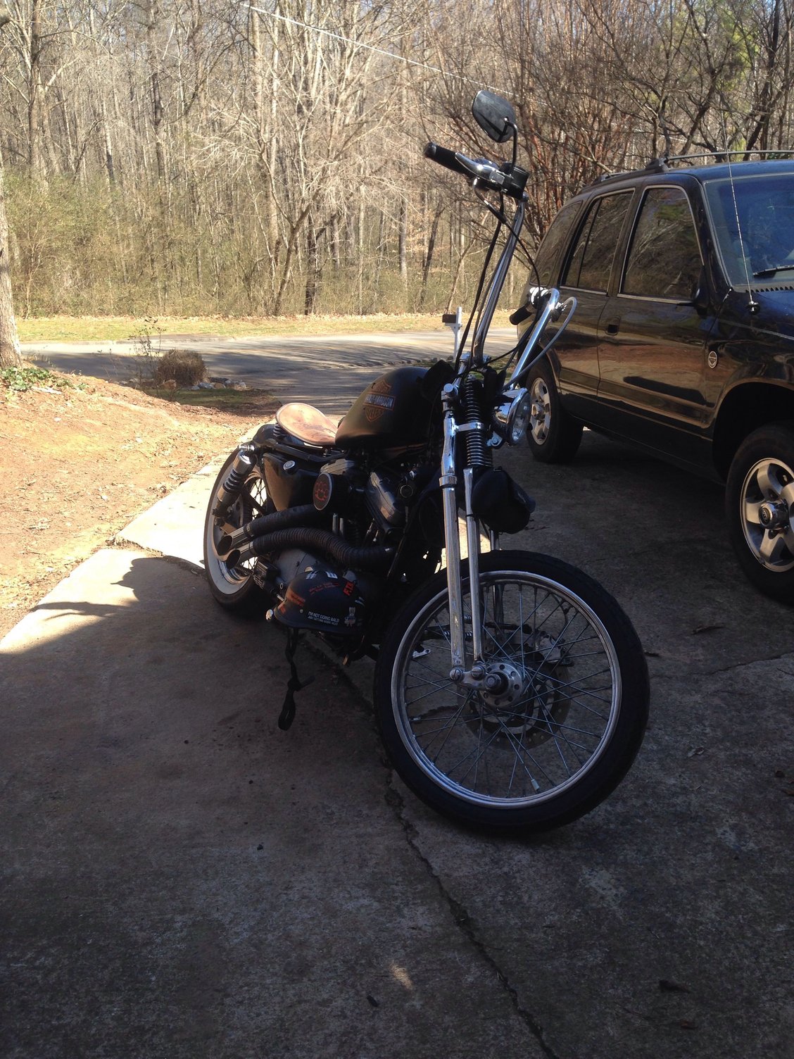

I have a 2003 sportster 883. I have been having problems with shifting. When cold it shifts perfect, but after a few miles and it gets warmed up, it will start shifting in between gears, and feels as if I'm in neutral. I have tried shifting every way possible so I know it is not my error. I adjusted my clutch probably 60 times, I put new fluid in it, tightened up my primary chain, adjusted on my linkage, and still not getting any better. Does anyone have any ideas? Please help!
Also, the timing was off causing shifting problems before, and I had that fixed a few months ago and everything was perfect till now.
Thanks Jason
