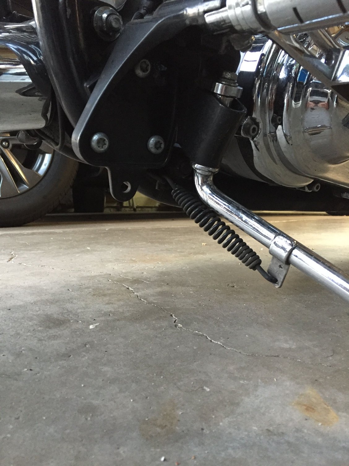

so i dumped my chinese crap ebay "billet" cast junk forward controls and found a used set of steel forward controls im gonna fab some plates to move them forward but........where does the other end of the spring go? on that little tab with the hole? anyone send me a picture?...the kickstand has a tab...but wheres the other end go? anyone with a pic would be awesome....thanks man!

there is no place on this forward control that has a tab for spring im stumped....its a softail standard foot control plate...just sold my dam welder...no what!..

Here ya go:

hey QC your awesome man....can i get an eye dimnesion as to...is it directly behind the kickstand?...and maybe a measurement of how long the spring is (not stretched)...harley made few different length springs...i will be posting pictures of my plates to show you guys what i did....thanks QC im getting closer to a fix...choppers...ahhhh gotta love em....
