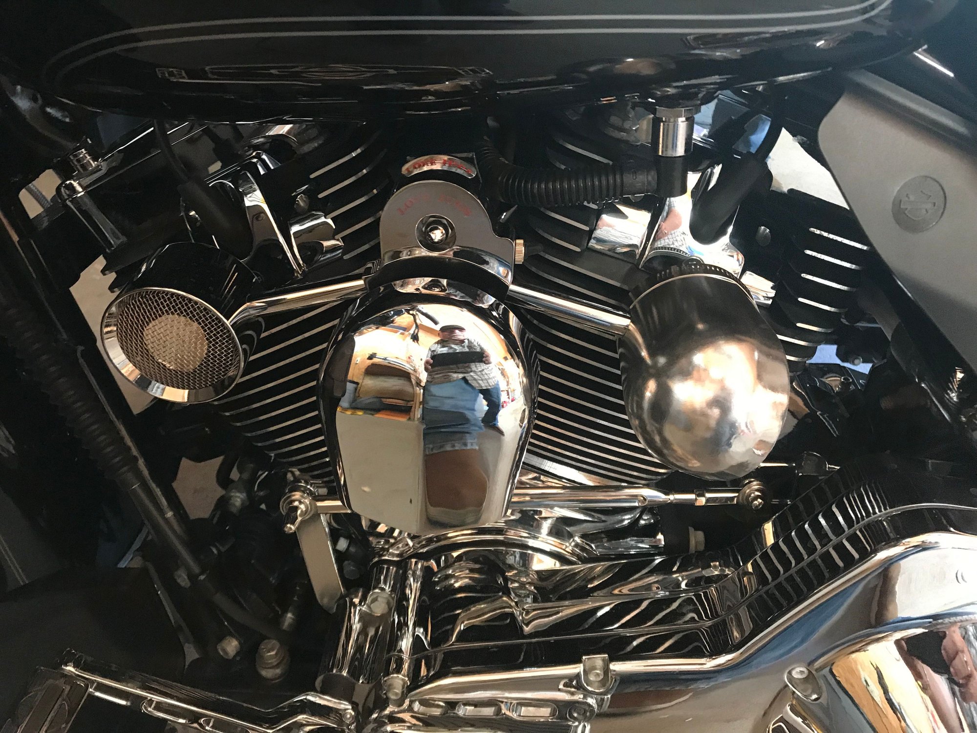

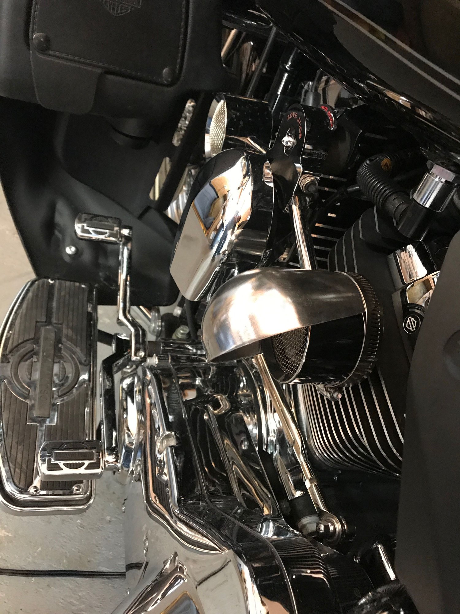

I have a set of Mighty Mites on my 2006 FLHTCUI w95" Conversion and factory sidecar. After the 95 conversion the heat coming off of the motor trapped between the car and RH side of the bike made it brutal on the passenger. I called them(love Jugs) and explained that I wanted to reverse the flow and remove the heat as opposed to blowing cool air across the cylinders. They said easy deal. The told me to take the set screws out of the housings and flip the fans around and it worked great. Changed the temp from the hack/bike area by a HUGE amount. But problem two reared its head. The rear cylinder fan blew the hot air directly at the riders knee area. I needed to direct it rear ward as opposed to sending straight out. I found that an aluminum ice cream scoop fit the housing so fabbed it into a "Scoop" by removing the handle and polishing it smooth. I attached it to the rear fan and it directs the air rearward. Made the bike rideable again.
Pix in trial stages, hose clamp holding it in place
Directing airflow rearward. Scoop now attached with SS screws.
Neither they nor I have any idea how long they will last with the heat going around the fan motor, time will tell. I can tell you they are a good company and their product works as intended, and also not exactly as they intended. This has made a miserable situation much better.
