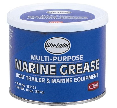

i used marine grease... asked all over and got no better answers.

When I worked in a frame and fork shop, we used the boattrailer grease like the guy above. Most damage we saw to the bearings was rust, and some greases break down with moisture. The marine grease protects.

I have a tub of boat trailer bearing grease that's salt water rated, and that stuff is way too stiff to pump. I wouldn't try to load it into a grease gun, and pump it.
