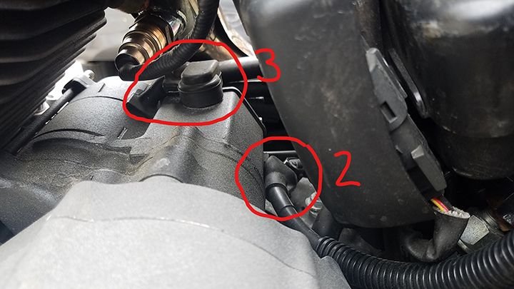

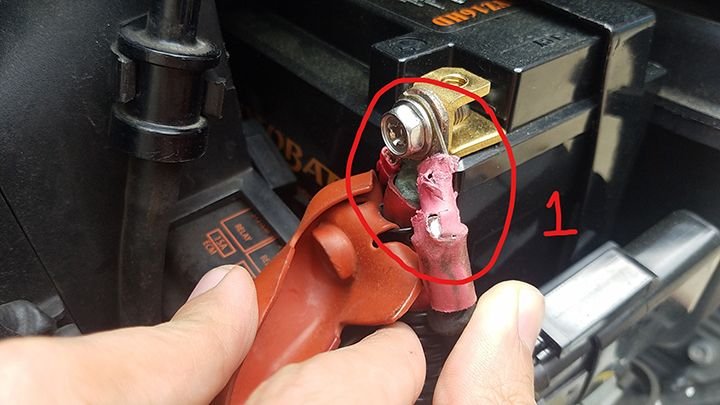

  • 1- Battery Terminals - The positive terminals are all rusted. I didn't check yet as to whether the rust stops at the terminal or has gone down to the wire.
  • 2- Power from Battery. The boot isn't completely on... got to check for rust there.
  • 3- I'm guessing this is another power line... am I right?
  • 4- Primary Cover Ground - corroded as hell. Need to trace it to see where it goes. Could/Would this effect the starter turning over?
  • 5- ? Is this the signal from the switch?
Is the starter grounded via a cable or through the body of the starter to the engine/frame?
Old May 5, 2018 | 01:33 PM
MURPHCC1's Avatar
MURPHCC1
Joined: Apr 2013
Posts: 5,873
Likes: 3,850
From: Cape Cod
Any rust or corrosion is gonna suck up energy in the form of heat..........clean/replace any corroded wires......if you cant clean it all, replace it all,
BOTH ground and hot wires!!
