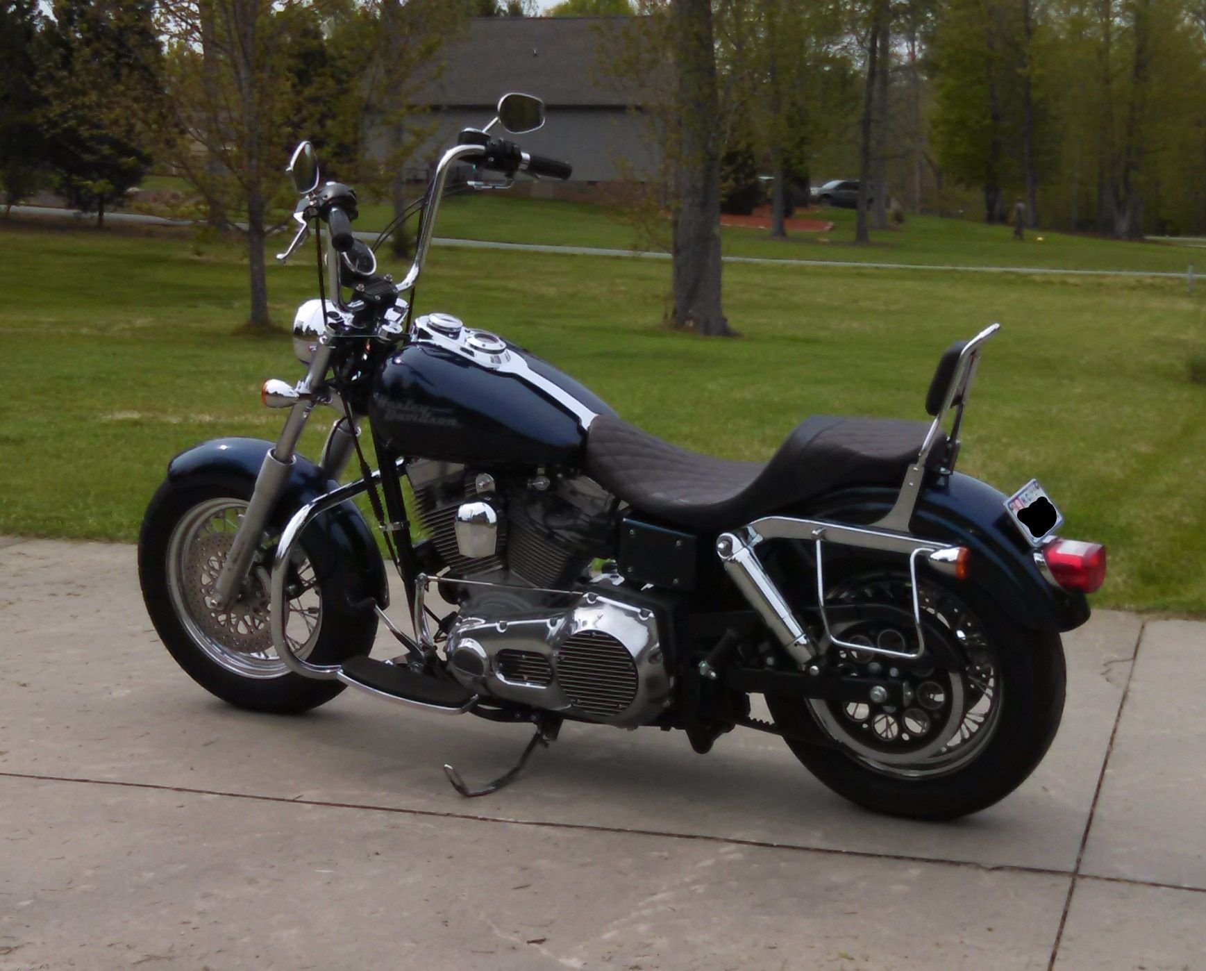

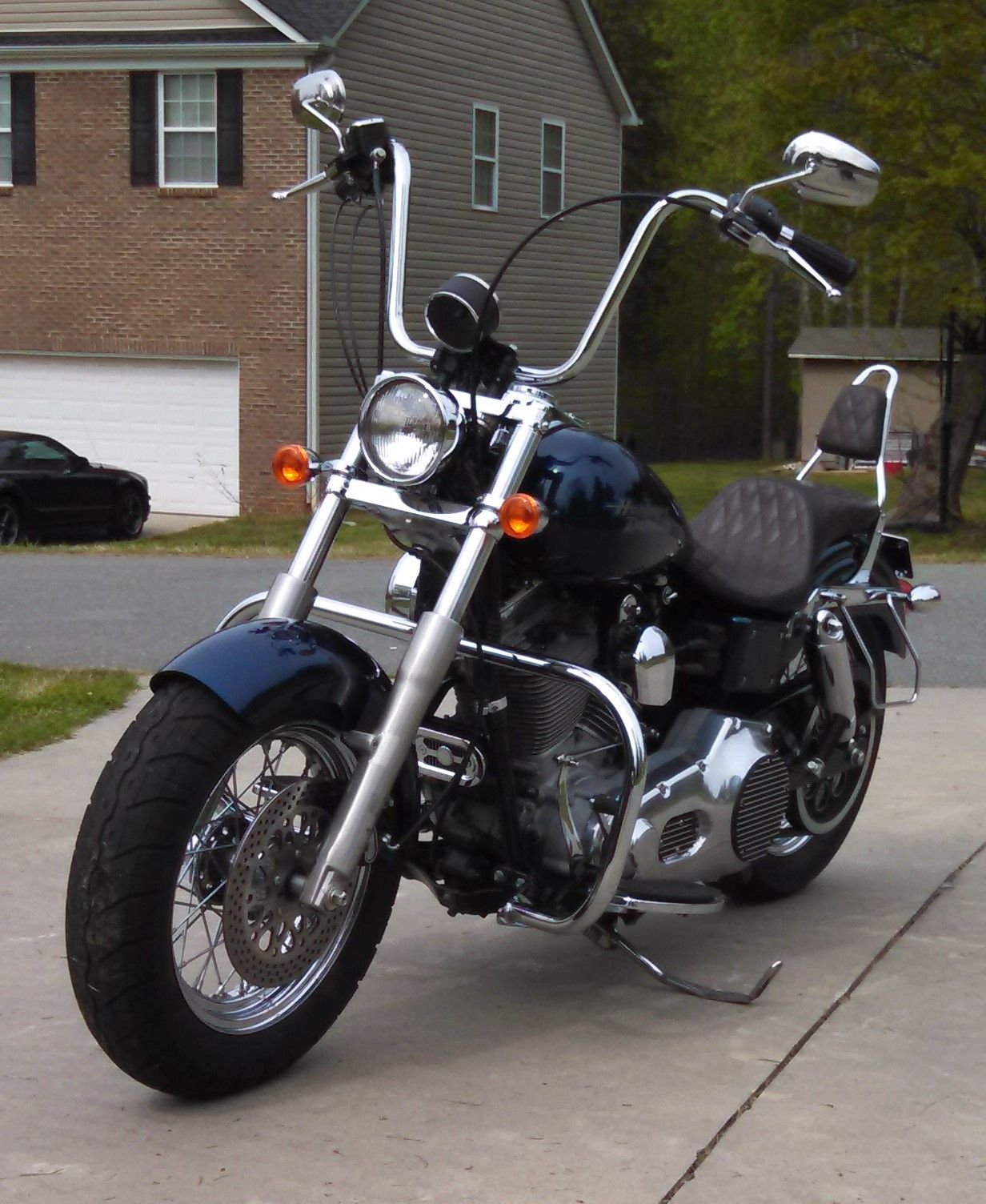

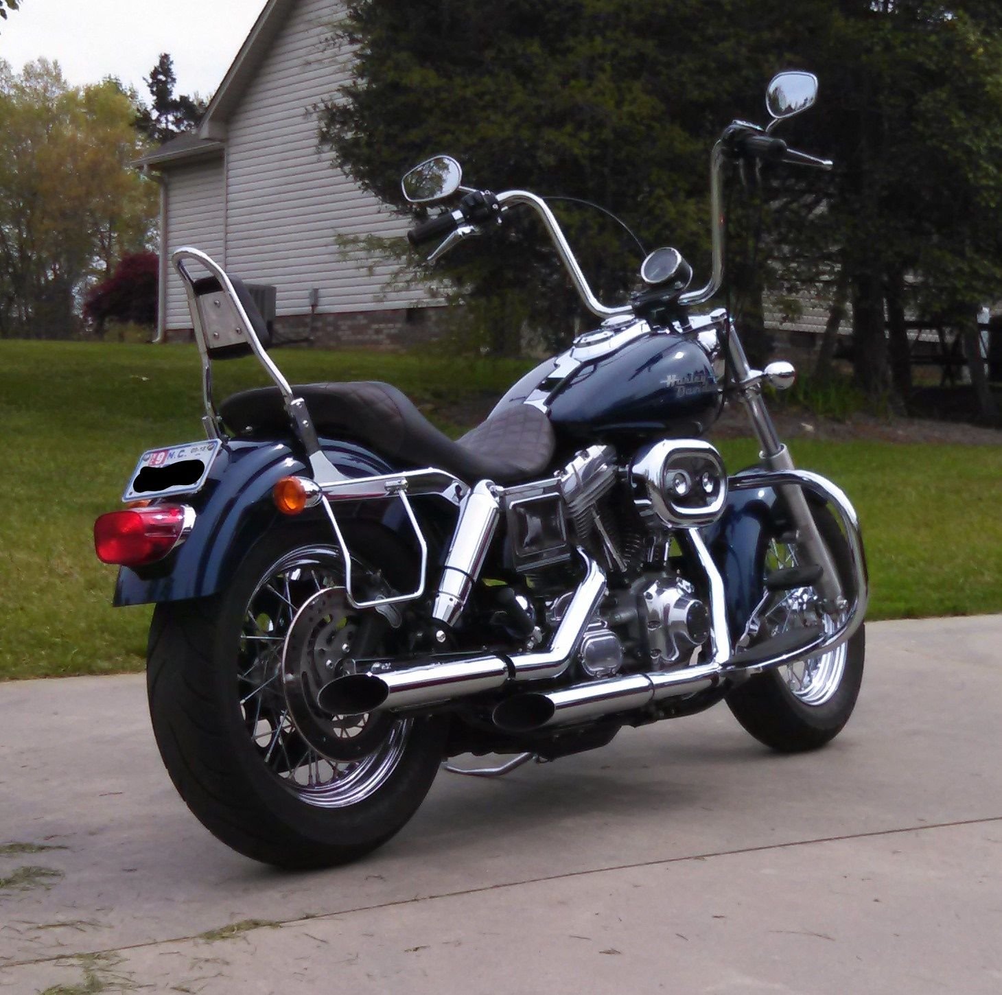

Bars that hold your hands at shoulder height are perfect. For me, that's 12" to 14". Running Khrome Werks 12"s now & trying to decide if I want to go back to the Burly 14" narrows I ran on the FX front end. Set your bars so that when you are sitting up straight, your arms are fully extended. No fighting the wind/"sail effect", either.
No surprises or handling issues, but on a barge like mine, I ain't strafing no apexes. If it feels awkward while turning the bars for low speed maneuvers, bring 'em back a bit closer to you. Stock risers are fine. I've got my Super Glide set up for comfort & with a good seat (C&C Custom Seats, in my case), FLD footboards & apes make a 200 mile putt a piece of cake. No back, shoulder, wrist, or hand pain whatsoever.

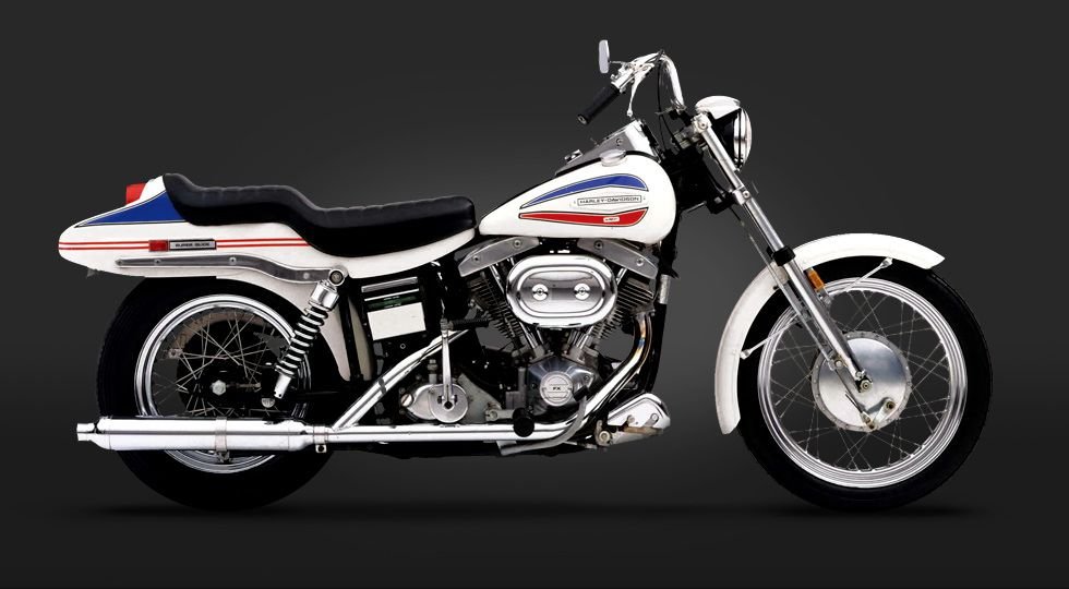

My guess is he was going for this

Thank you. Yeah, it's a Sporty a/c cover over a Hammer Performance "Crush" a/c with 2.25" tall filter element. They only list 'em for XLs, but with a DK Customs carb bracket, it bolted up like it was made for my bike. Nomadmax is right, I was going for a more retro look. I'm a child of the '70's, so I had to sprinkle some of the late '60's through early '80's styling cues I loved as a kid on 'er.
I'm sensitive to wrist angle & like bars with less pullback & drop at the grips. My current 12"ers put my hands perfectly at shoulder height, but I do notice a smidge of lower back discomfort with them. I'm going to rotate them forward just a hair to see if that alleviates it, otherwise I'll need to go back to my 14"s (which I'm dreading, as running the wiring throught the bars & futzing with the connectors is a royal PITA).
