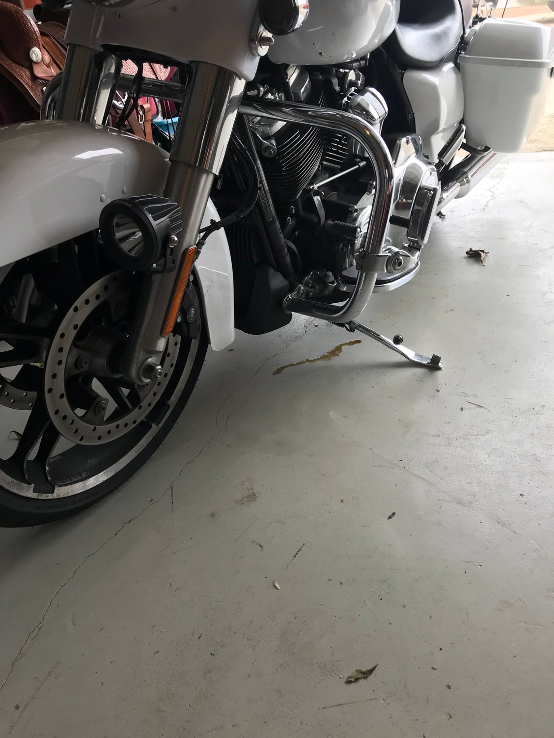

i have a 2017 SGS. On two separate occasions, I have discovered a a very small oil leak that travels in a line, approximately 10 inches. It does not happen after riding; in fact, I have noticed the oil about a week after the last ride.
I have looked under the engine, and I don’t see a source for the leak. The amount of oil oil is minimal- it wipes up with a single paper towel.
Any thoughts on the cause? Thank you.

The clutch cable o-ring isn't sealing. The oil will "travel" along the clutch cable housing to it's lowest point, then drip. Check to see if your clutch cable housing is oily. It may likely be underneath the engine cases.
Also, different oils have different odors. Engine oil is different than trans/primary oil. Unless you use the same oil in all 3 holes...

My guess would be residual oil caught in the oil cooler cover after servicing. When changing the oil filter oil will run down the front of the engine and gather in the cover.

First, try to figure out if it Primary or Engine oil.

Possible stator grommet leak. This is fairly common. If it is the grommet the permanent fix is to replace the entire stator - maybe $300.

Norty, I have seen what you are saying many times before, but the OP'S bike is a 2017 with a hydraulic clutch.

Clean/degrease the engine (thoroughly), check all fluid levels, take bike for a ride & see if it repeats. Then, if so, look for the point-of-origin. Your pics just show the run-off, but not where it's leaking.
^^^This ^^^

Has the oil and filter been changed recently ?

Clutch and cable is on the other side. AND it's a hydraulic unit.
