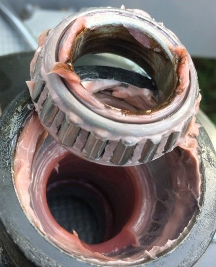

I've repacked roller wheel bearings, but ***** from a Harley, hell no. If you have a reason to get to them, it's a good time to put new ones in. In less critical and stressful areas, I have re-used and re-greased ball bearings. Cleaning the old grease out is a good idea for a few reasons. I clean all the grease out of new sealed bearings when I'm not satisfied with them because I don't mix greases; sometimes it works, sometimes not and you seldom know what the manufacturer used. I've used red Mobil One synthetic and it seems to be pretty good stuff, but if you see red grease in a bearing you didn't put there, don't assume it's Mobil; there are other red greases such as Chevron Starplex and Mobil 28 that are hygroscopic, meaning they mix with water, which some engineers seem to think is great, the water will be in suspension and not have droplets settle out that cause rust. Wrong, so wrong, the grease eventually saturates (you can tell because the dark red turns pink) and everything it touches will rust - I've seen hundreds of bearings ruined by running hygroscopic grease too long without changing it, and locked up due to rust. So continue cleaning out the old grease, even if it's in a new bearing you think just needs a little more. And some greases are just incompatible, do undesirable things if you mix the wrong two.
For those of us with trailers, and as an example of what kind of grease to use and what not - OEM grease in many trailer bearings is Chevron Starplex. If you run it through a hard rain, probably a good idea to clean and grease their wheel bearings. Here's what one of my trailers with Starplex looked like with probably less than 100 miles on it, no rain, just sitting outside, had owned it a couple months at this time. Was checking it for a 1200 mile trip and really glad I did. One of the bearings already had a little surface rust, even though it was packed with this stuff. I've seen many bearings with Mobil 28 looking like this, too.
Cleaned and packed with Mobil One. That and Starplex look the same, new.
