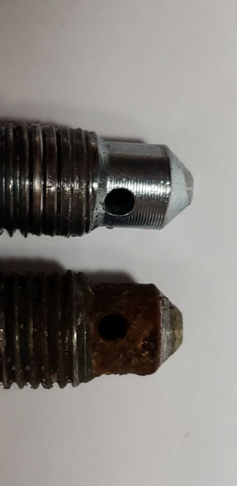

Compare the beveled ends of the two very carefully, they may be different angles. If so it won't seal and will leak right through the middle.

Here's two side by side.

Beveled end looks close enough. Run a blind tap into the hole to clean up any munged threads.
The threads on those don't seal. They're just regular machine threads. All the sealing is done by the tip of the bleeder screw in the bottom of the hole. As long as it's getting down to the bottom, and as long as there aren't any defects in the bottom of the hole, it will seal.

Dude, those threads on the new one are seriously messed up. They don't seal, but they do have to not be stripped out so that they can tighten up enough to seal the beveled part. You may have a big problem. Like said previously, chase those threads in the caliper, and be very careful with a new bleeder and don't overtighten it...
