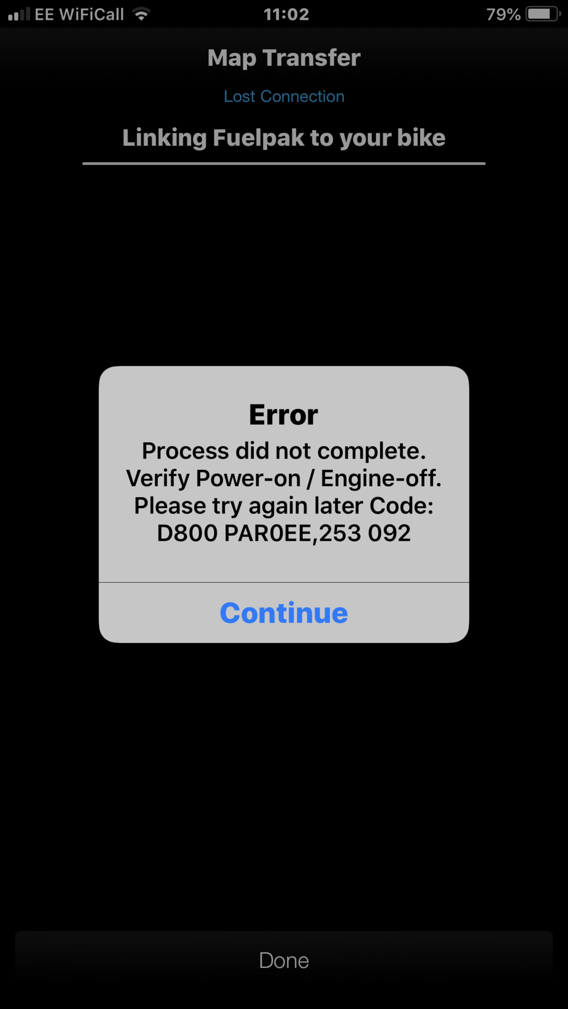

Hi, I installed an FP3 to my sportster which decided not to link and failed to download a map. After a few emails flew back and forth between Cheyne at Vance and Hines and myself they kindly sent out a new unit. Exactly the same problem occurred.
I have gone through all possible combinations of fuse pulling, updates, walking away and self harming. Anybody throw any light on this problem code as I can’t find anything helpful on line.
All relevant details including screenshots were sent to V&H which led them to send the replacement.

Sounds like your bike may have an electrical issue. Possible bad ECU....
One FP3 not working could be an isolated case. Two not working is a trend and the common denominator is your bike.

Sounds that way, just can’t believe this has not happened before and I am unable to find anything online that has a definitive solution

Try deleting the FP3 app off your phone and redownload the app. Could just be a err in the app.

Be sure you have no other devices linked to your phone, remove all BT. Next I would try another phone or tablet if you have access.
Done that, but your still loading it from the cloud so it’s not a ‘fresh’ install.
Gone with iOS and android with no other BT connected.

If none other are linked, that should be fine but who knows, easy enough to remove devices and add back later. Maybe roll your bike to another location in garage or somewhere close by but in range of your wifi- maybe some type of interference? Just trying to eliminate everything but bike.

Can I ask you the dumb question? Is the ignition switch on your bars is on?
Thanks, I have moved the bike to different locations and tried it on Wi-fi and mobile data.
