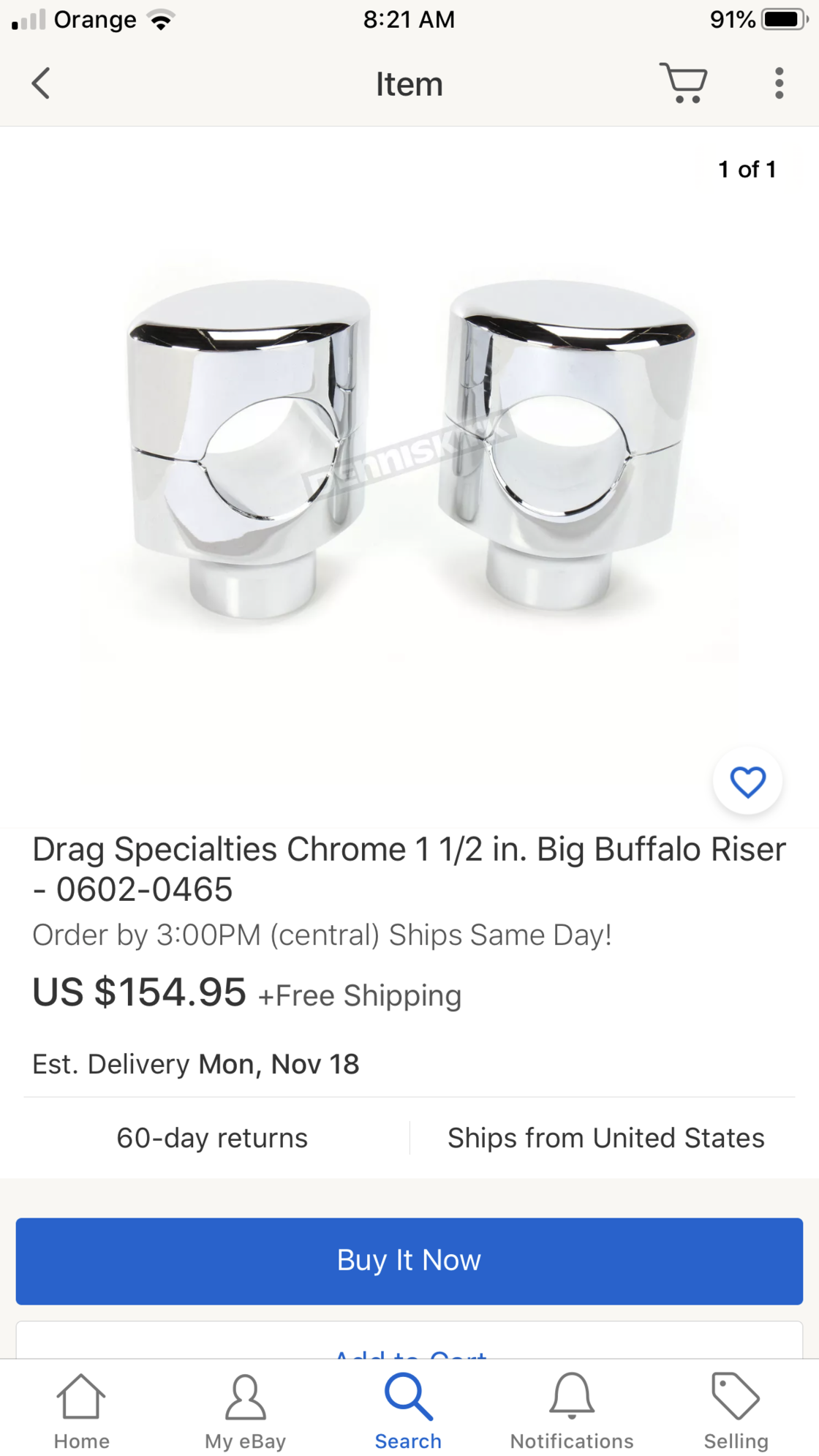

I have a 2012 softail heritage, I changed the handlebar recently. I got new riser bushings, drag specialties 1 1/2” risers and the drag specialties big buffalo beach bar installed to the bike.. took it from the dealer ship and I noticed that the risers are off (not aligned) there is a slight tilt. We tried to align them but they stay the same.. is it possible that the problem is with the bushings or the handlebar? Though I had the same risers and the handlebar on my fatboy before I made the switch. The bushings are different. Need the help

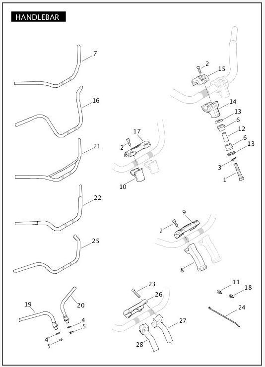

As you can see from the factory parts diagram some risers are tilted. You didn't specify which riser model you have, some photos showing what your seeing would help as well.

Those risers with Arlen ness riser bushings

That part number lists several bikes/makes but not for Harley https://www.dragspecialties.com/prod...umber=06020465

These are the bars? https://www.dragspecialties.com/prod...umber=06014293

Yes, but when I emailed them they told me that it works with harley’s specifically 1 1/2 handlebars..
one of the risers is off a little

I can't see how that's possible unless they weren't installed correctly using all the parts.
I'll bet the inner sleeve is missing, part #12.

I agree that those risers are not for Harleys.What bushings are you using?

You have the wrong riser bushings.You need 08-005.
