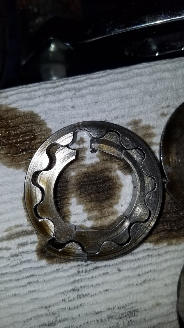

not necessarily. I did cams and headwork over this past winter. When I was reassembling I put the cam plate on with oil pump attached, it was loose so I could do the alignment but it was a huge mistake. The pump didn't seat all the way onto the crank and during the torquing process the outer gyrator broke. I didn't feel it then or while doing the alignment procedure on the oil pump. This wasn't my first time doing it this way but I guess I just got lucky the other times. Upon initial startup I had the typical lifter clatter and let it run for 30 to 45 seconds...the oil light was off the whole time. It wasn't getting any quieter so I shut it down and chewed a few finger nails off then ran it again for another 30 to 45 seconds...no improvement. I looked at the dipstick...nice clean oil there. Popped a pushrod cover and looked into the lifter galley and it was dry as a bone. I knew somethingwas up. Pulled the cam cover off and some old oil came out...hmmm...not pumping for sure. Pulled the cam plate then it was clear as can be what was wrong. That was a mistake I'll never make again. You need to pull the cam plate and look that oil pump over. With the two gyrators and the wave washer I believe it should stick out of the pump housing .180 or so...i could look in the manual but I have a cat on one leg and the dogs head on another lol. Pull that pump ! Lol
this will ruin your whole day...luckily all the pieces stayed right there. I ended up with a shifted crank and a bad rod bearing later that season, not sure if this helped bring that on or not but it sure has been an expensive year.
