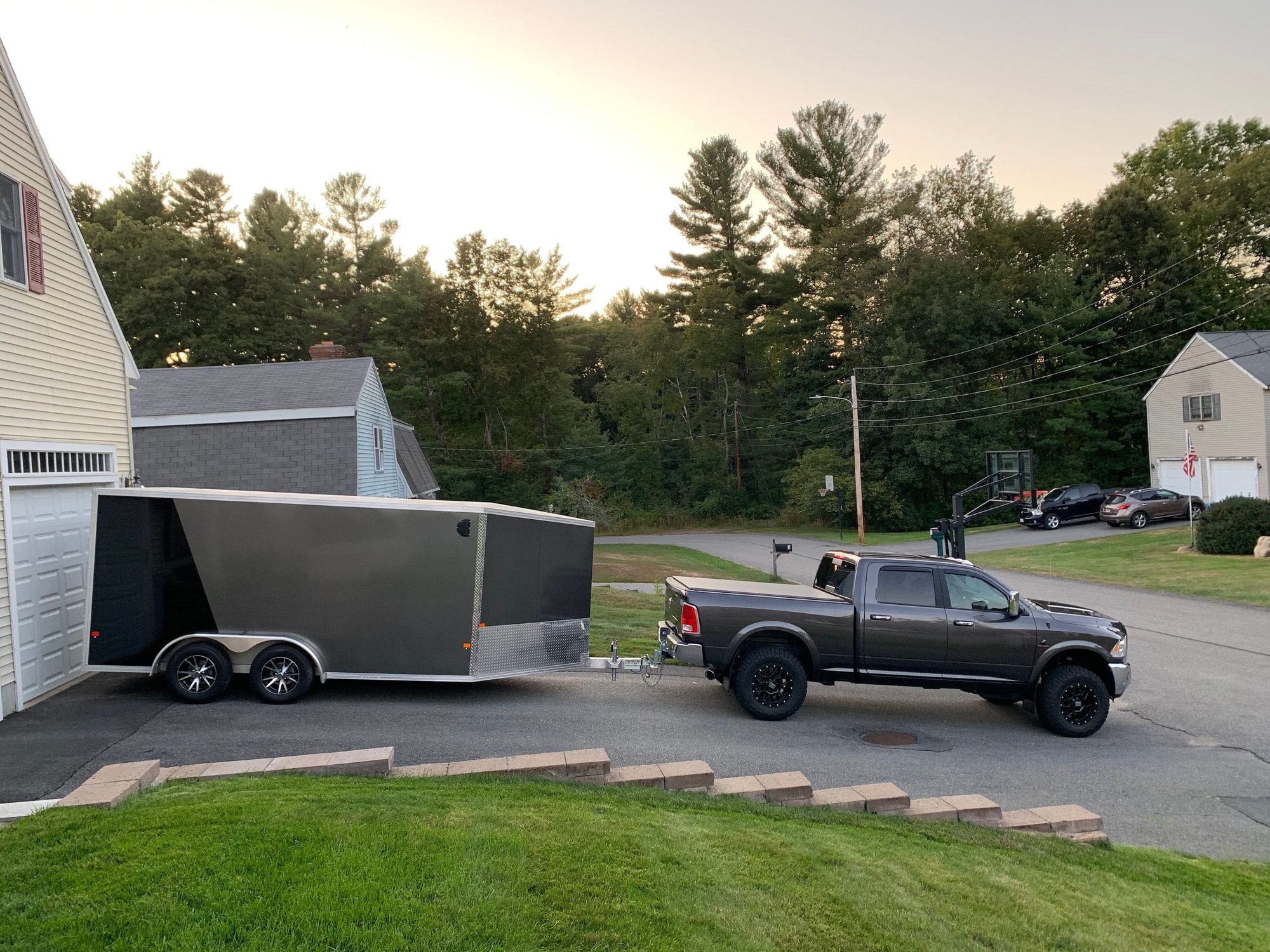

14’ EZ Hauler sloped v-nose snowmobile / motorcycle trailer. Dual torsion axles with brakes. Tows sleds and bikes like a dream. Headed out to Sturgis with it this year.

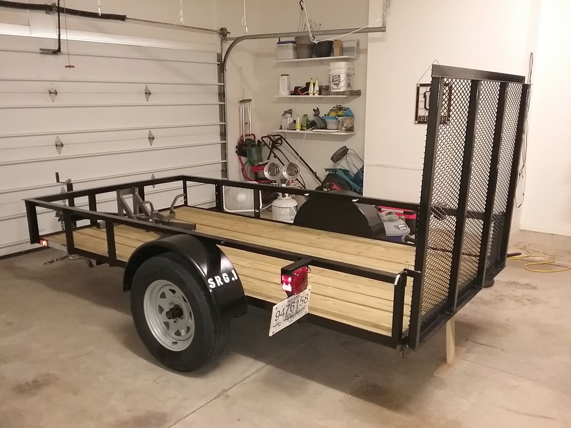

I've trailered my 2018 FLHCS a couple of times with good success. Once to Florida (about 3000 miles total) and another to Pennsylvania (about 1000 miles). I took a less expensive option, as do many, by buying an open utility trailer and setting it up to haul my bike. I did not even buy a truck, but used my medium sized SUV which has a 2000 pound towing limit (I'm just under that). Here are the steps I took:
>Carefully reviewed my Mazda CX5 towing capacity and reviewing trailer and motorcycle weights. Decided it was a "can do" project.
>Finding a suitable hitch. Went to Etrailer.com and got the correct harness and frame-mounted hitch. Installed the wiring harness myself. About $200 cost.
>Looked for a new utility trailer at <1000 pounds total. Decided on an AMO 5x10 ft (A510G) trailer and found a local outfit that sold them. Decided on 15" tires. Trailer has 3500 pound capacity. $1200 cost.
>Found a local RV sales company to mount the hitch. $50 cost.
>Tag, title for trailer was about $120 for first year.
>Bought a Wheeldock chock. $225 cost. Mounted on trailer. I also take this off and use it in my garage. It's great!
>Bought a high-end lock for the trailer so someone can't easily hook up and steal the trailer. Trimax model #UMAX50: $55.
>Modified trailer to make it suitable for hauling bike: Added a board to underside of bed, perpendicular to bed boards under rear wheel of bike ($10). Added an additional square tubular steel frame piece to center of ramp to better support bike when loading/unloading ($50). Added 8 eye-bolts to frame to hook up straps to keep bike better secured when driving ($50).
All totaled I have about $2000 in the trailer. Photo of trailer before final modifications:

Steve;
Thanks for the detailed response and picture. I'm planning to do almost exactly the same thing. I have a Silverado and a 7 x 12 V-nose enclosed, but I don't want to take out a loan out to buy gas for a 2500 mile trip!
Wife's daily driver is a 2017 Equinox with the V6 AWD and a 3,500 lb. tow rating. I have a 5' x.8' open utility trailer that looks much like yours, except mine is showing the wear and tear of hauling lumber, gravel, railroad ties and anything else you can imagine for years. I'm going to sandblast & paint it, and install a new deck, new lights, new tires, and a new set of 3,500 springs. It's a tilt bed, so I won't have the ramp on the back. It also has electric brakes, so I'm going to add a brake controller and harness to the Chevy.

Chief 150: Thanks for the thanks. A refurb on your open trailer will do the trick.
I just take off the windshield, strap the bike down well and go. Drove through rain (quite a bit) and a little bit of sleet on my Florida trip last year. The bike can take it fine. Just a quick wash at my destination and it looked like new. The bike is made to stand up to wet weather. We've all ridden in the rain. You might want to think twice about a home-made cover that will catch the wind and may rip anyway. Just a thought.
