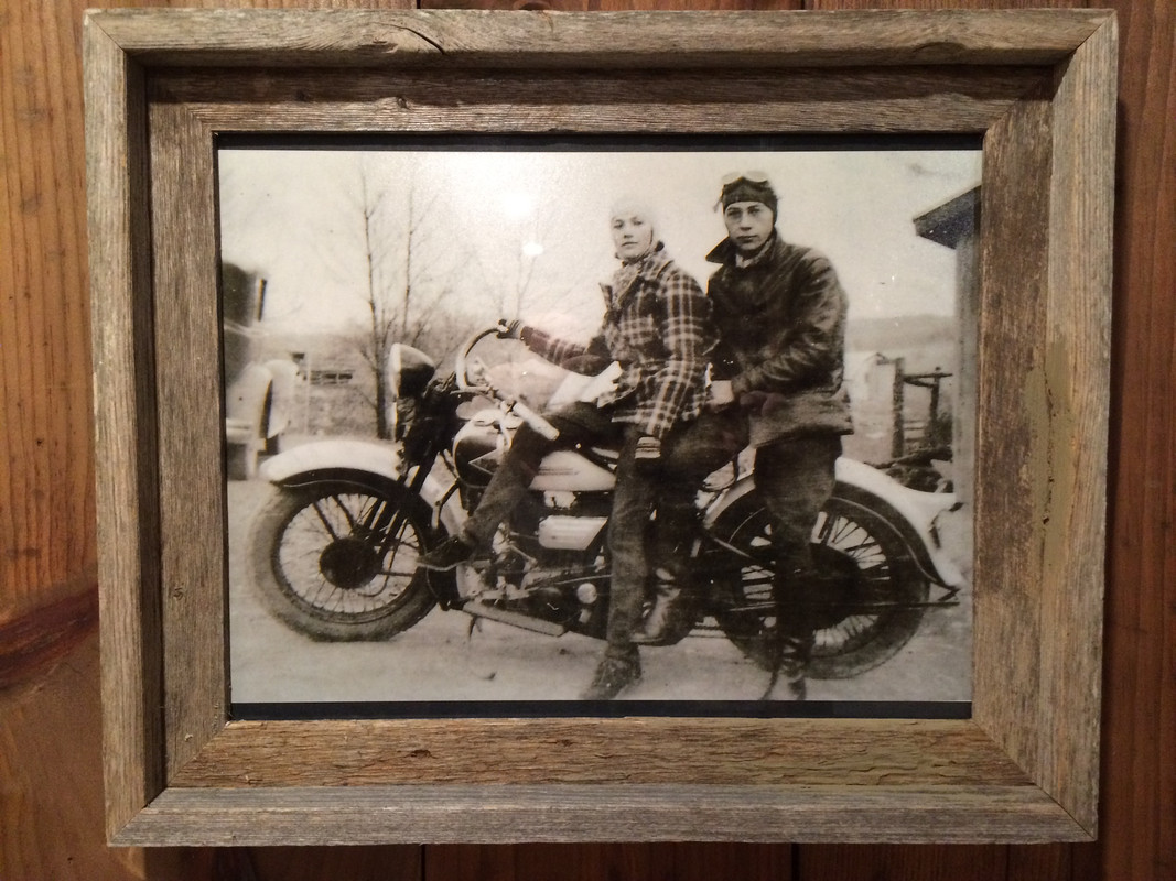

My wife's grandfather died a couple of months before his 100th birthday, Among the pictures displayed after the funeral was this picture of him and my wife's grandmother. The best info I could find was that the picture was taken in the late 30's. Can anyone identify the bike?

WL (DL?)45 would be my guess.

Looking at the primary cover, Four-Five.

[QUOTE=470004;19612463]Looking at the primary cover, Four-Five.[/QUOTE
yes it’s a flathead but:
drive chain on left side equals big twin
its a V model
early had flat fenders, 32 on had the round as pictured with Art Deco tank graphics
last year is 36 37 brought in U model flats with recirculating oil system V was “ total loss”
availability in 74 & 80 cid

You are correct. Did not see the final drive chain on the left side. My bad.

That style of front and rear mudguard was introduced for 1934 and H-D called it an ‘air-flo’ design. Also introduced for 1934 was that ‘air-flo’ tail light.
However, the tank graphics indicate the bike is a 1935 model and you’ll see the same graphics on the 1935 prototype below. There were at least eight types of V-series machines available for 1935 but three were equipped with sidecars and one was a competition special. That leaves four so I imagine the bike in your photo is one of these: Model VD, VFD, VLD or VLDD.

The only difference I see in the two pictures is the seat mount. Was there an option for a one or two person seat?
