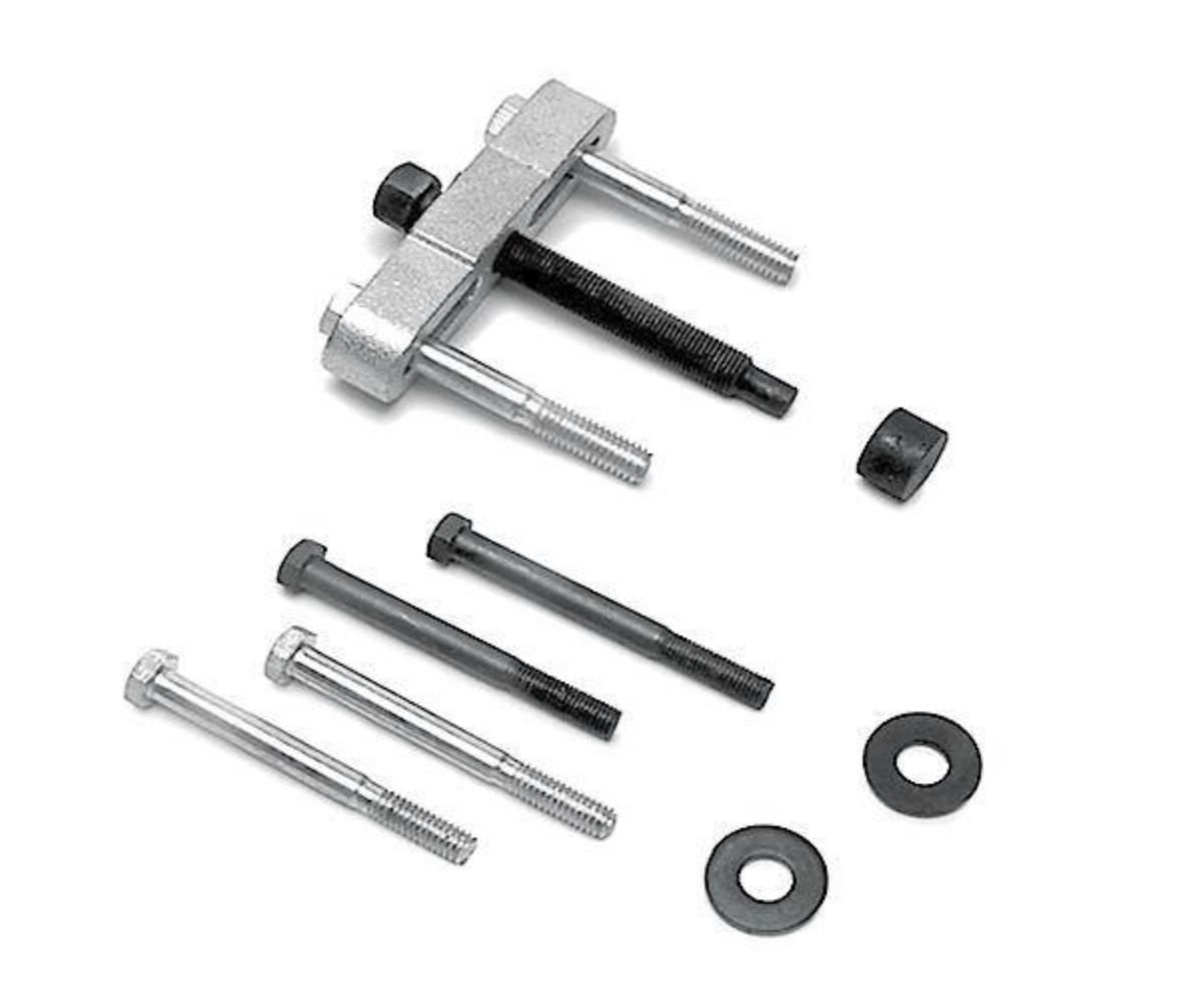

Hello I have a 2009 fat bob I am replacing the stator on it seems when down too the magnet it doesn’t want to come off I can wiggle it by hand and move it out a little bit, but then just seems like you hit a wall any advice it’s my first time doing it so pointers would be helpful thanks in advance

Are you talking about removing the rotor or stator?
The rotor should have two holes that allow use of a puller if you are unable to pull it off by hand (they can be a challenge). The stator has four fasteners and should pull off fairly easily, but you will need to push the electrical connector into the primary to get it out. It is recommended that the four fasteners are not reused.

Gotta give it a firm pull. As stated above use a non invasive tool to insert into the two holes.

I use a cheapo steering wheel puller for that, available at most local auto stores.

on my evo it was impossible to pull off with bare hands, so I used metal clothes hanger wire and bent hooks on the ends to fit in the holes on the side of the rotor. It worked.

You need the "Armstrong" tool. Lol...time to call your buddy that has forearms like Popeye. It'll come off...its just tough to get a good grip. Make sure your fingers are not behind it when you re-install it

Just had to do this... you need to shave off the inner primary or it will not come off. Get a
Dremmel tool l. It will take some time, don't take too much off. Good luck. Otherwise, you will need to pull the inner primary. Do a search, you will find the procedure.
